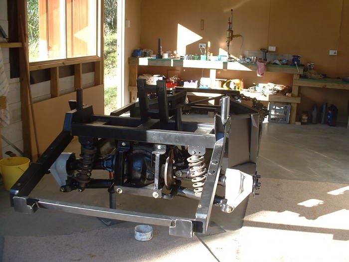

This is the "traditional" jag rear end in an RMC with shortened driveshafts to allow for dished wheels

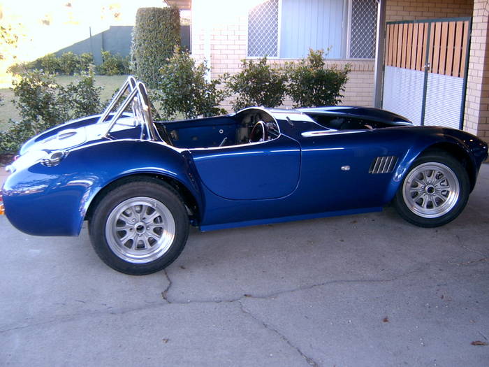

These are australian produced 5 stud Halibrand replica wheels for those of us can't afford the real thing. (I am envious of your wheels Plums)
http://www.clubcobra.com/photopost/d...m/IMG_3454.jpg
400TT 07-30-2007 05:59 AM
Originally Posted by T.L.
Plums,
That is exactly the type of look that I am after. Where did you get those Halibrands from?.
They are Vintage Wheels. Knock-off wheels with an adaptor. See http://www.vintagewheelsus.com They are truly beautiful quality wheels in the flesh.
To fit any of those wheels you need a car that can fit deep dish wheels. e.g. Harrison do a special fabricated independent rear etc to fit. Others like G Force, RMC etc should be able to squeeze them in. 17" versions(plums) have better backspacing(half inch extra) than the original looking 15" versions.
Plums 07-30-2007 06:43 AM
They are a very nice wheel, I am very impressed with the quality!!!!
The G-Force has the standard 56 inch (I think) track, which is supposed to be what the original cars ran. I did get the rear-end shortened by 20mm per side though, this did make these wheels fit slightly better, but was more to enable the drag rubber and wheels that I wanted to run....
The wheel centre colour is the standard "some name" grey.......

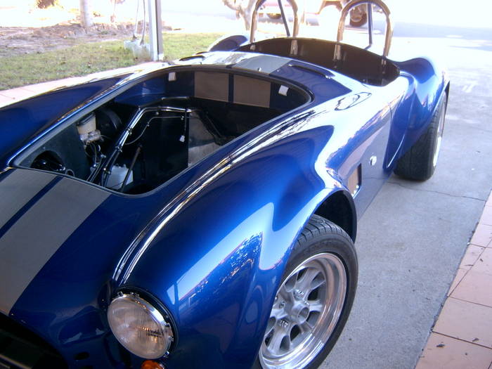

Here's another shot of deep rear wheels on my RCM (not be be confused with RMC :confused: )
http://www.clubcobra.com/photopost/d...m/19080cc5.jpg
RCM is also based in Melbourne if that helps you.

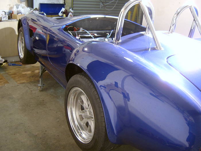

I have just (Saturday) dropped my Harrison's onto the Millaz wheels you refer to. Here are a couple of shots for reference.
http://www.clubcobra.com/photopost/d...m/SV400339.JPG
http://www.clubcobra.com/photopost/d...m/SV400312.JPG

The wheels above have frontspace of 125(R) and 80(F) - in 16". I reckon the rears could even go out another 10mm or so, but I won't really know until I do all the alignments.
Geof
400TT 07-31-2007 03:56 PM
Looking good Geof, I was wondering how you went getting it down on the ground.
Won't be long now until you will be posting a engine starting up video here. :D
Those front space measurements are with standard Harrison front end and R32 Skyline rear-end.
sambo 07-31-2007 06:46 PM
Looks great Geof! How wide are those wheels? I'm guessing 8 and 10 inch? Did you consider the "Traditional Racer" style?
400TT 07-31-2007 07:50 PM
Yes, they are 16x8" & 16x10".
Here is a photo showing Geof's rear dish.
http://www.clubcobra.com/photopost/d...m/SV400150.JPG
I reckon Cobra's look good with front wheels under the front guards, but the rear wheels look great filling right out the rear guards, as long as it doesn't cause rubbing etc.
So at the moment it does look like Geof's could have specified more front space(less backspace) on the rear, but he has gone for a bit of insurance with his offsets, which is never a bad idea.
