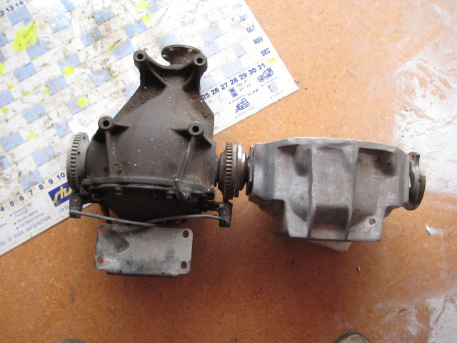

alffie 10-07-2007 02:06 AM
http://www.clubcobra.com/photopost/d...Oct_07_001.jpg
Jac Mac has made a 9 inch case that is worth a look
Jac Mac 10-07-2007 10:03 PM
Thanks Alffie, you pic skills are 'way' in front of mine. That is a Holden BTR in the pic beside it, Half Shaft flanges are about 1.500" wider than the BTR & Driveshaft U-Joint center would be in virtually the same position as the Holden U-Joint given that the flange would be approx 1.500" rearwards from c/l of U-joint. There are a couple of other pics from different angles in my gallery.
