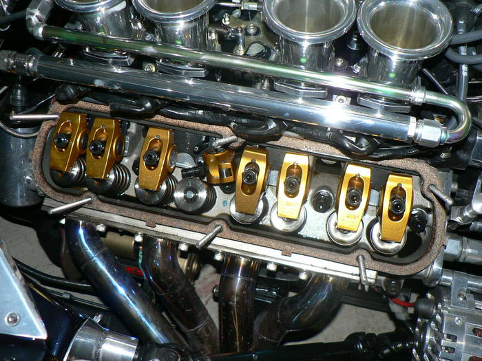

Philm 11-22-2007 04:05 AM
Filled my Pants
Had a run last Wednesday and things were not so good the engine began to run rough and developed a miss that was something it has never done.
I had a run and the car was a slug. Checked things over and though I may has stuffed the plugs with a leaner tune.
Decided to have another go and it was not real good. Put the car on the trailer and headed home.
This morning I removed the rocker cover and this is what I saw.
:eek: :eek: :eek: :eek: :eek: :eek: :eek: :eek: :eek: :eek: :eek: :eek: :eek:
http://www.clubcobra.com/photopost/d...m/P1100361.JPG
After I changed my cloths%/ I had a good look and everything looks ok and the thread is fine, I think when I last set the lash I may have turned the stud and then it slowly worked itself loose.
Phil

Plums 11-22-2007 02:51 PM
I used to use Loctite super stud lock on the rocker studs and also put a dob of "anti-tamper" paint on them facing the intake, (so I could see if they were moving).... I did this because a mate of mine with the same motor, (308) used to find loose rocker studs after every meeting.
After using the Loctite we never saw a loose rocker stud again....
