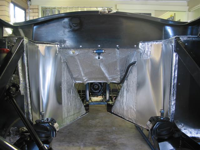

http://www.clubcobra.com/photopost/d...insulation.jpg
Look at the passenger footwell, inside wall, you can see a cut-out at the top of the aluminium heat shield towards the rear, that's where our engine harness went across.
