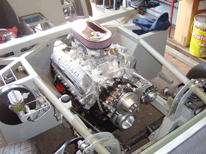

I now have the Mass-Flo system fitted
http://www.clubcobra.com/photopost/d...ad_Gas_176.jpg
http://www.clubcobra.com/photopost/d...ad_Gas_177.jpg
I spoke to the engineer prior to purchase and produced a number of documents that suggest that the mass flo system is particulary good in relation to emmissions. Short story is that a set of test results from Utah (FFR Cobra), running a stroked windsor with AFR heads (just like mine) passed testing without catalytic converters. I don't know whether he was baffled by the bull or genuinely agreed, but either way, in principal, its good to go. Yeehaw.
Put the big oval filter on there, and it almost disappears.
And I think it looks good.
Regards
Hogster

Mando 06-27-2008 04:04 PM
Hogster,
it just doesnt look good, it looks great, love the big dizzi!
What size injecters are you running?
Regards.

Mando - I am running 36lb injectors. Estmated 420hp so the should be about right.

acecob 06-29-2008 03:05 AM
Regards
Hogster[/quote]
That doesn't look good.
It looks "Friggin awsome" ;) ;)

C0braed 06-30-2008 02:18 AM
The pictures dont really do this injection system justice, especially for a Cobra its gunner be good

Looks great Hogster. Just shows what can be done with the 'humble' 302. The Mass-Flo is the way to go and a way I hope to follow before too long (at least after rego). What did you have done to the motor: alloy heads, cam, ???
Merv
hogster 07-01-2008 04:32 AM
Hi Merve,
Forged Crank, Rods and Pistons
AFR 185 Alloy Heads
Mildish Comp Cams camshaft 31-442-8
and the rest is just blingy stuff.
Having said that there was a lot of extra work that went into the engine, like my nervous sweat whilst I filed and sanded away at the alloy heads (at the direction of Eddie) apparently I was making horsepower. Time will tell.
I am hoping 400 plus.
Hogster
