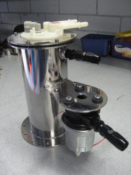

Wally68 07-28-2009 06:41 AM
http://www.clubcobra.com/forums/pict...pictureid=1319Hi Greg
I've gone with the standard VZ pump and reg mounted in my swirl pot ,with a Carter lift pump attached to it. Have just finished building it and bolting it in the car.
Its a pretty simple system so I think It should work fine.
Dave

Peter Dore 07-29-2009 11:35 PM
I have the separate lift pump, swirl pot, high pressure pump setup, but the one described by WKB is a whole lot easier and more cost effective, and does the same job. It's the way to go IMHO.
Pete
gjkrv8 07-30-2009 03:35 AM
Pete
Peter, I agree, I have a lot of plumbing for the external swirl pot and two pumps and regulator option.
If my tank we deeper I would have gone for the in-tank option with it all in one unit. Wally68's swirl pot pump comb option looks quite neat though. I didnt have that much room to fit that one.
