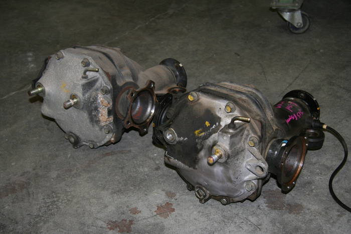

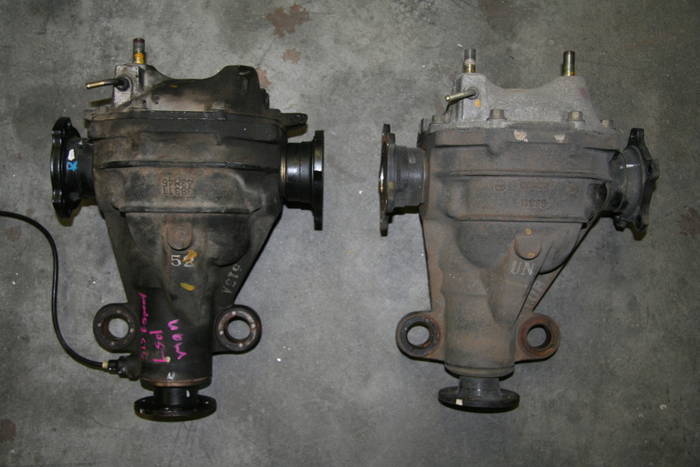

sambo 06-01-2009 07:48 PM
Merv, the diff swap was straightforward as expected. A few pics below and see my gallery for larger photos and a few comments.

Well thanks to Scott at Venomcobras I have finally started this delayed project. I have an R33 DE 3.58 ratio diff to replace the existing R33 (4.11).
http://www.clubcobra.com/photopost/d...R33_DE_Box.jpg

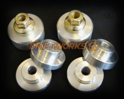

This should all go in with relative ease, although I will replace the rubber bushes on the nose of the diff with solid ally ones. I believe that the relative size of the old and new diffs are the same (both R33)

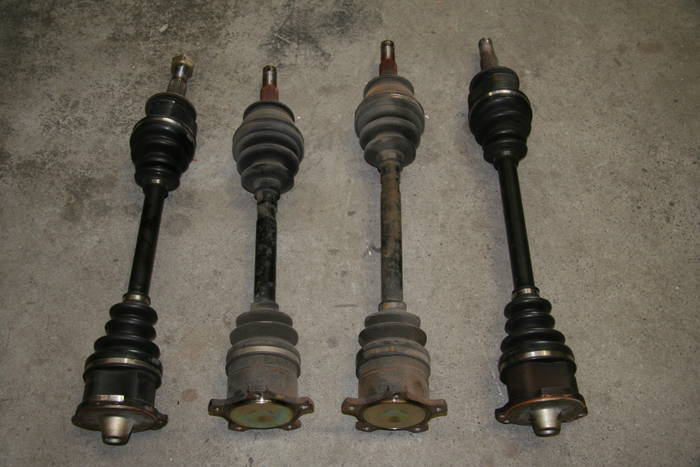

The predicted hassle is the half shafts (well described by Paul and Warren above). They have a different bolt pattern (6) from the existing ones (5). In addition they can have a different number of splines on the shafts themselves.
http://www.clubcobra.com/photopost/d...aft_flange.jpg
I can get some different shafts I guess but some have used an adapter of some kind. I am wondering how that works? Surely it would have the effect of lengthening the half shaft?

Hi Merv, that six bolt flange pattern looks exactly the same as the 3.7 ratio helical that I sourced from a manual S15 200SX. As I think I mentioned earlier the auto version used a viscous centre and may be different.
I got the S15 half shafts with the centre and it went straight into my R33 cradle. They seem to be interchangeable in that regard in the R32, R33 & R34 Skylines. The S15 diff is borrowed from the R34, so it also matches - not sure about earlier 200SX variants though. As for splines, exact match for me.
Try to get the 12 bolts and nuts with the shafts. They have a unique shoulder on the bolt that is hard to match at the bolt shop. Genuine Nissan items weren't cheap!
Please let us know how the road manners change with those solid bushes. I'm also looking to replace the old rubber bushes in mine.

And I found some photos of a stripped down S15 centre below. You can see the inner half shafts but not the outer.
FS: S15 Torsen/Helical standard diff [SYD] - Hardtuned.net
