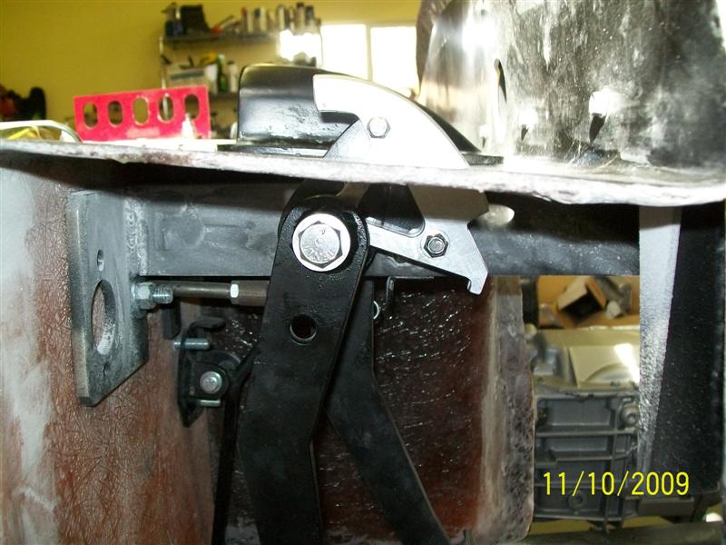

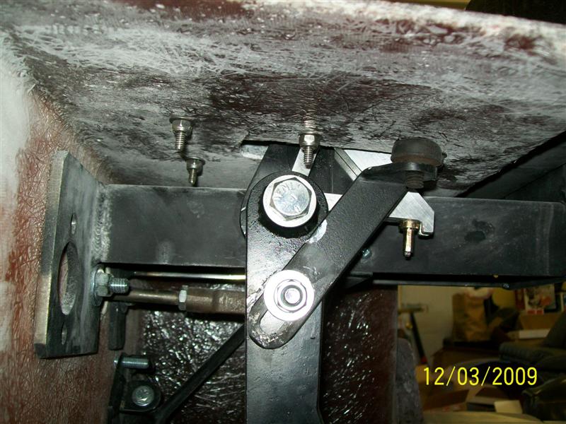

Wbulk 08-29-2010 12:37 PM
Quadrant Modification
Lou, I will not argue this method vs. the hydraulic method, but I will give you the detail of how I did mine if you want. Send me an email and we can talk on it more. I loaded more pictures so you can see some detail. In one picture the cover is just setting behind and not bolted on yet.
Wayne
http://www.clubcobra.com/photopost/d...rm3_Small_.jpg
http://www.clubcobra.com/photopost/d...nt_Medium_.jpg
http://www.clubcobra.com/photopost/d...t3_Medium_.jpg
http://www.clubcobra.com/photopost/d...t2_Medium_.jpg
RET_COP 11-05-2010 05:31 PM
Wayne and Alan. I did what you guys suggested. I bought a Steeda quadrant and did some cutting, grinding and burring, to massage it into the pivot sleeve and weld area. I pinned it with one screw. I had to elongate the cutout in the fiberglass. A little back breaking work underneath the steering column but it looks and feels great. That was the one achilles heel on my car. It cost me a car show and a slow ride home in 2nd gear on Rt1 in July!!! I feel alot better now. Thanks again fellas.
Lou
