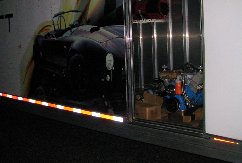

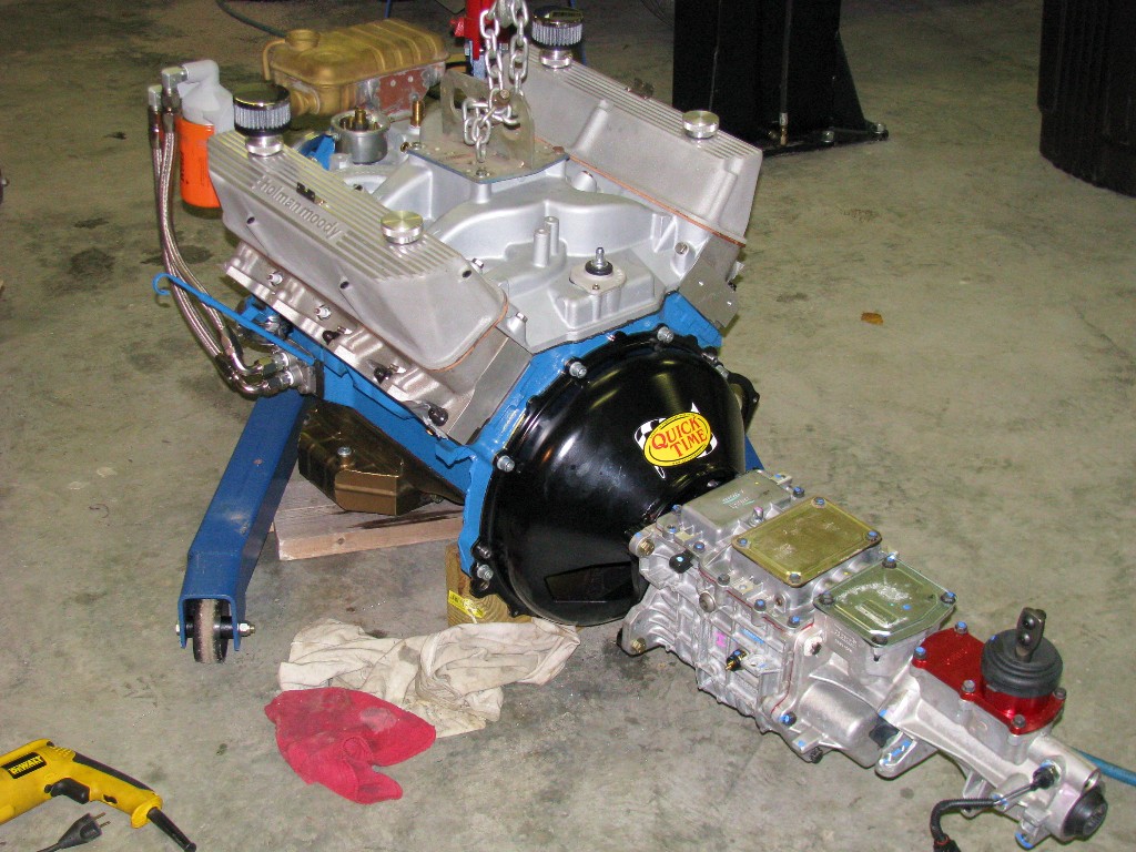

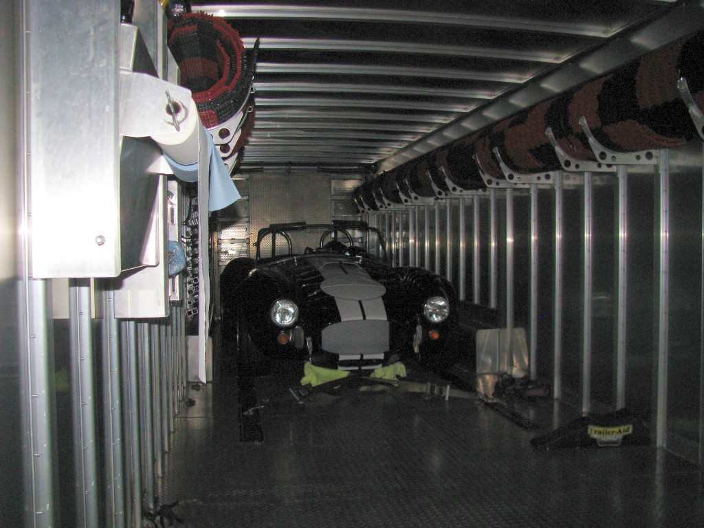

Update! After talking with Tony and getting that great offer from he and then Reg, I went down to the TRR and met Reg face to face for the first time. He was quite busy at the show but still talked to me for a good 30min about the ins and outs of putting an FE into a BDR. They also do not have an FE or a car for an FE to work on in Boynton Beach which works out nice for me. Seems there are quite a few tricks to getting this accomplished that I'd have had to find out the hard way. Things like the steering column has to come out before the engine will fit in and several more. Having my new motor hovering above my car only to realize that it wasn't going to fit would've sucked big time. I say "would've" because Reg decided that he wanted to have his guys do the engine install as well. As he said, the BDR was not designed with the FE in mind even though it can be done. But to be done requires some tricks that his guys already know very well. Of course he could've also been thinking: (now ya gotta read this with a SA accent in your head) "There's no way I want this big oaf messing about in a car my guys are going to work on.":rolleyes: That being said, I couldn't care less.:LOL: The BDR crew themselves are going to bolt my engine in, doing all the little mods necessary to get it done. Then they're going to fix me a set of headers which will work, insure that my side pipes are aligned, send my headers out to be coated, reinstall them, then bring my car back to me next week! All I can say is "Holy crap guys! Thanks a ton!" Here are a few pics of the car and engine being picked up last night.
http://www.clubcobra.com/photopost/d...s/IMG_3069.JPG http://www.clubcobra.com/photopost/d...s/IMG_3070.JPG http://www.clubcobra.com/photopost/d...s/IMG_3071.JPG http://www.clubcobra.com/photopost/d...s/IMG_3072.JPG http://www.clubcobra.com/photopost/d...s/IMG_3073.JPG
The engine, BH and trans along with the car and the the transport with Bill heading down south with BDR687.
I'll let you know what happens next week! Steve

Where's your clutch fork? Or HTOB?
lovehamr 12-10-2009 10:14 AM
Ex, I've got some carbon/graphite gaskets that I'll be trying first.
Jay, don't have that set up as of yet. Turns out my Shiefer flywheel is for a Long style clutch and as you know my clutch is CF. It seems like whenever I do a project over time I do something like that. What can I say, sometimes I'm a tard.
Steve

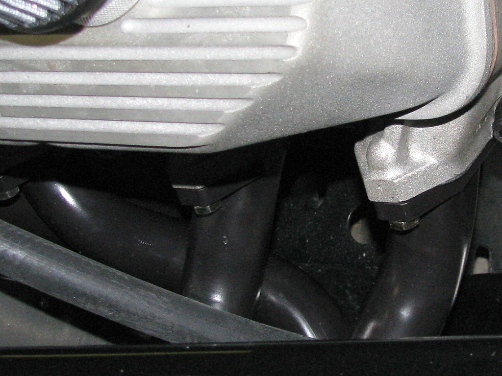

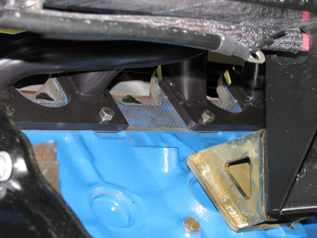

Guys I could not be more happy! The engine is in, the headers fit perfect and look great. I've probably got a couple of weeks of sorting things out to make them the way that I want them but the BDR crew has come through in a big way. Here are a few pics as she now sits:
Side pipes are level and straight
http://www.clubcobra.com/photopost/d...0/IMG_3192.JPG
The headers are beautifull!
http://www.clubcobra.com/photopost/d.../IMG_31941.JPG
http://www.clubcobra.com/photopost/d.../IMG_31951.JPG
http://www.clubcobra.com/photopost/d.../IMG_31891.JPG
Unfortunately there is no way I can use my cool H/M valve covers
http://www.clubcobra.com/photopost/d.../IMG_31911.JPG
This is with the VC a good half inch off of the head
http://www.clubcobra.com/photopost/d...0/IMG_3190.JPG
The BDR crew has really come through for me. I have to thank the big man Tony Martin for kicking this thing into gear. Tony, you asked me once what it would take to get me on your team? Well mate I am firmly there "on your team" now. Once Reg was cut loose by the factory he got my car worked right into Custom Cars schedule even though they were quite booked up and still are. Thanks Reg. Bill was responsible getting my car to and from my house even though he had the job and personal things pulling him in vastly different directions. Thanks Bill.

Doug I 01-10-2010 03:46 PM
any ideas on the valve covers you can use?
Those are some nice looking headers - a much better indication of what BDR typically does.
