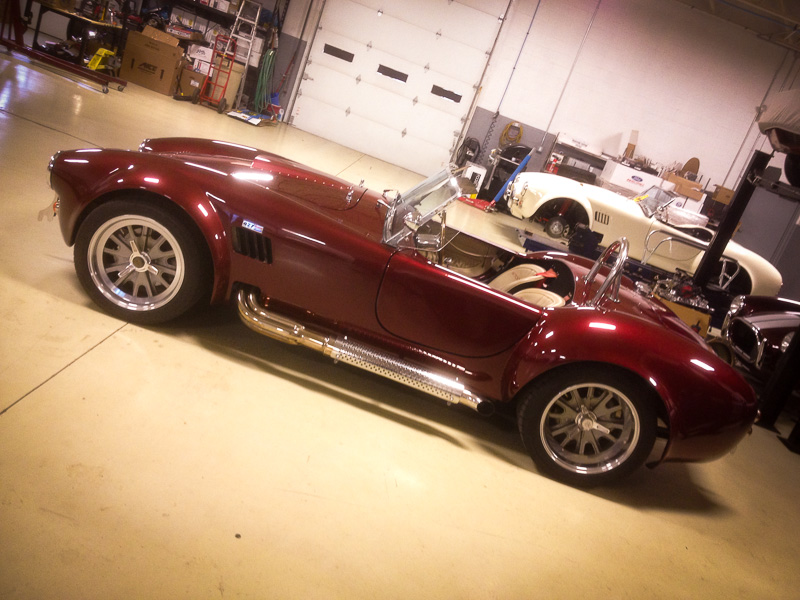

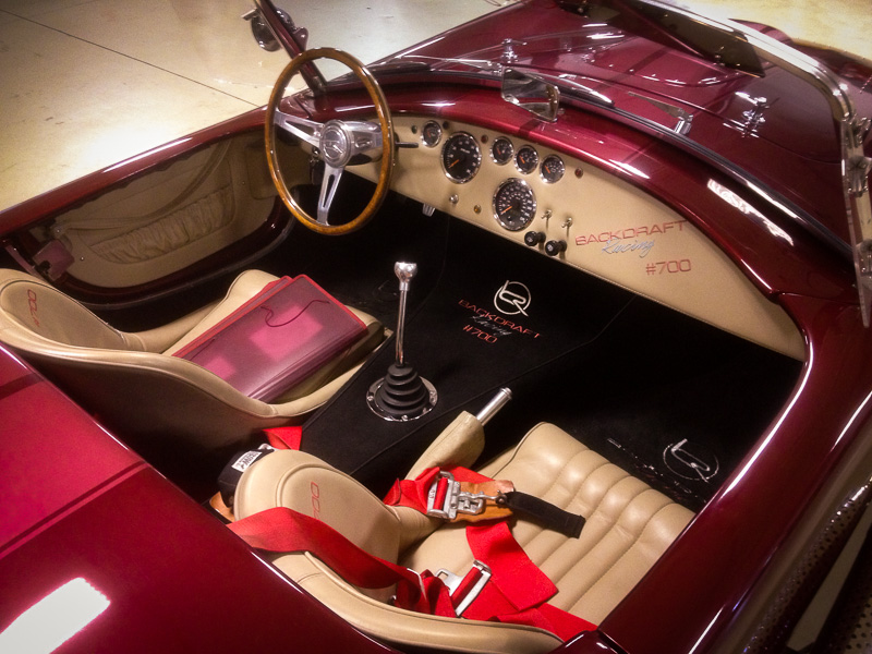

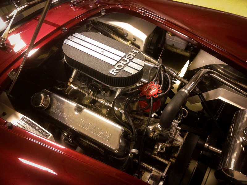

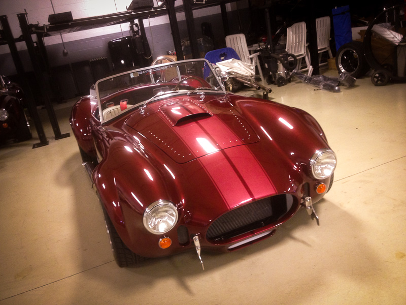

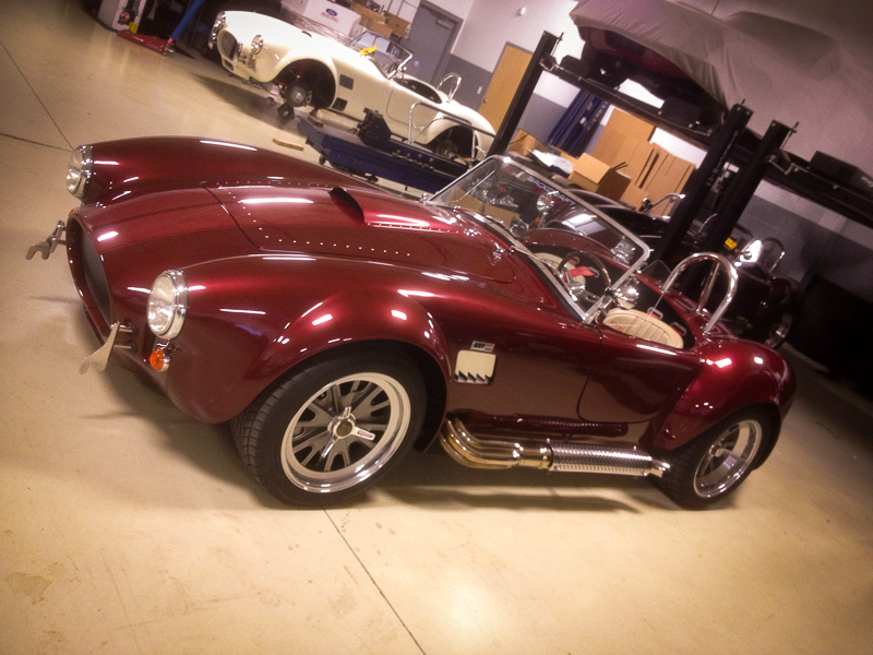

$42k http://www.vintage-motorsports.com/e...0/BDR700-1.jpg http://www.vintage-motorsports.com/e...0/BDR700-2.jpg http://www.vintage-motorsports.com/e...0/BDR700-3.jpg http://www.vintage-motorsports.com/e...0/BDR700-4.jpg http://www.vintage-motorsports.com/e...0/BDR700-5.jpg |
PM me the details please
My PM box is almost always full... here are the details.
Car #700 was originally assembled in FL. Monterey Red with Ghost Stripes (lighter). Interior is tan with embroidery denoting it is car #700. Engine is a Roush 427SR. It has 9,000 or so miles on it. Tan Cloth Soft Top. 17" Knock Off Wheels. 1965 Title/Registration. Engine was leaking from back of block so we have that completely out to service entire car. Oil got on clutch of course so that will be new as well. A few chips and scratches from 9,000 miles and some dull spots that should buff out (we are not at detail stage yet). We don't usually have consignments in this price range but the owner needs to move on. We priced aggressively due to the color, miles, and the owner has a loan so it has to be bought out through the bank etc. to get the title so for that "hassle" and rework $42k is the number. |
