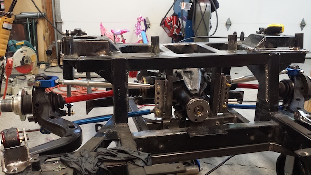

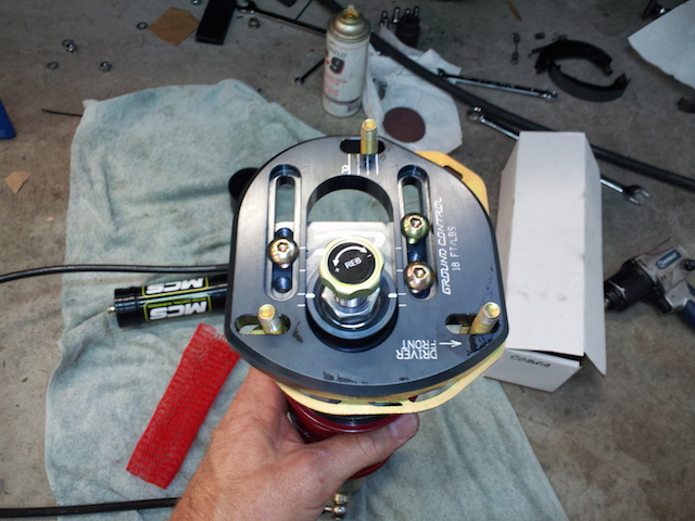

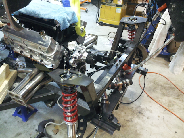

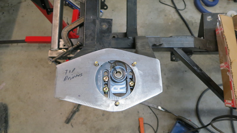

PLDRIVE 01-10-2015 05:09 PM
Lovehamr here u go. As for the cost. :CRY:
Kevin,,,,,,,,,, i still have the wheels u agreed to buy, but refused to answer the phone or return email. Yes i still remember;)
http://www.clubcobra.com/photopost/d...5_20_14_38.jpg http://www.clubcobra.com/photopost/d...8_10_20_48.jpg http://www.clubcobra.com/photopost/d...8_16_40_11.jpg http://www.clubcobra.com/photopost/d...930_120542.jpg http://www.clubcobra.com/photopost/d...s/IMG_0982.JPG
