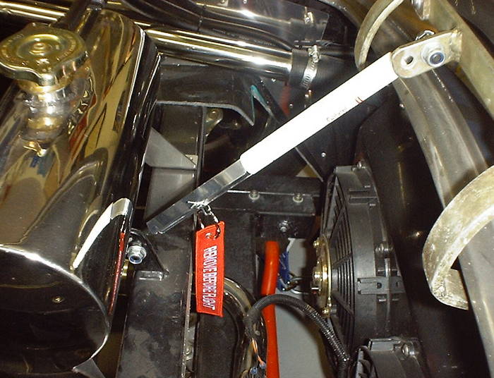

anyone have a solution other than a stick? have car 169 with one gabriel gaslift shock to hold it up. was thinking about adding another one. everytime the car gets on a slight angle the hood comes crashing down, usually when i am under it.

I have been working on a BDR Gaslift Hood-Lock. I have a prototype that I made and have been using it with good results. I am making about 10 more at this time.
It is polished aluminum with a "REMOVE BEFORE FLIGHT" flag. Looks really nice under the hood, when installed on the gaslift.

I can't quite tell from the picture but is this in addition to the gas shock or does it replace it. How long does it take to raise the hood and setup?
Is it bolted or does it clip into place? Hard to tell from the pics.

The Hood-Lock slip-fits on to the gaslift shaft and then it is hitch-pinned, so it won't fall off. The hitch pin does not grab the gaslift shaft and there is no modification to the gaslift at all. It takes about 10 seconds to attach.
The "REMOVE BEFORE FLIGHT" flag is attached to the hitch pin, so it won't get lost easily if you drop it and it's a cool reminder.:cool:
Once you see it, you will probably say "Why didn't I think of this?" %/ A simple fix to a common problem with earlier BDR's with the 4041 type Gabriel Gaslift hood prop.
