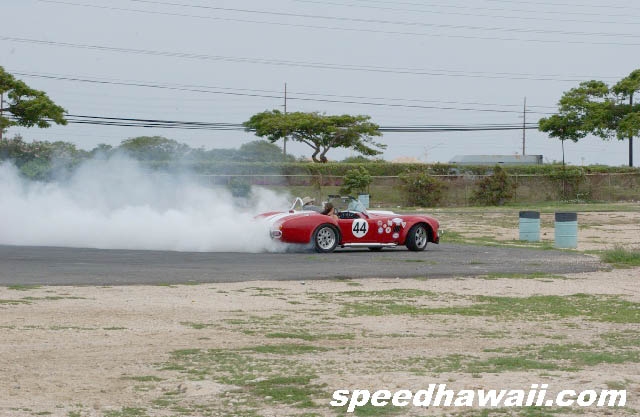

Try hard enough and you can break anything. Ford 9" is about the toughest rear end going, but I was able to 'break one' in my Excalibur with a lowly stock 302 and 5 speed.
How? Drifting... :D
http://www.clubcobra.com/photopost/d...l_burn_out.jpg
Burgs 01-23-2007 06:13 AM
Showoff!
