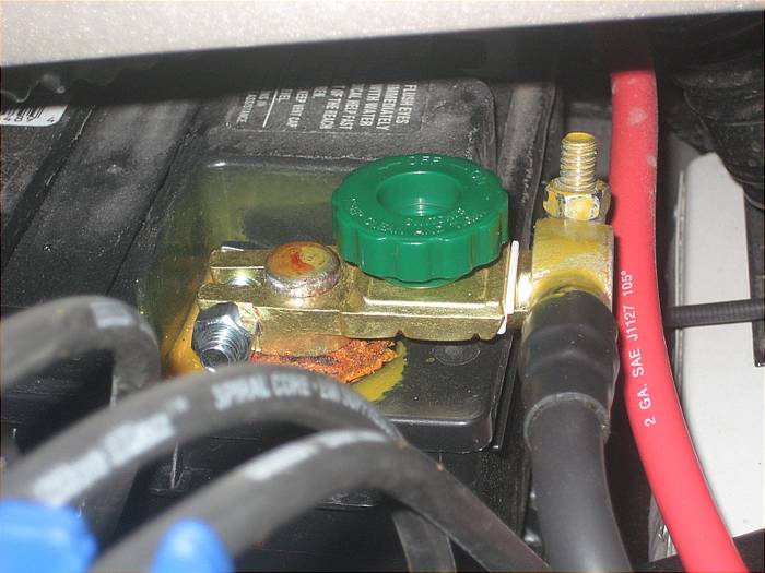

patrickt 01-09-2009 07:11 AM
Battery Disconnect Switch
Tim, I'll skip over the fact that a radio shouldn't be draining your battery and, instead, post this picture of the battery disonnect switch that I have on my Cobra. It mounts on the battery post and you just turn the green knob to disconnect. Actually, the green knob is completely removable as an anti-theft device, but I never bother with that. These cost about ten bucks, as I recall, and you can put them on in five minutes or less.;)

to answer your question they wired the radio directly to the postive terminal of your battery, your cuttoff switch is after that or they wired the radio to the battery side of your battery cuttoff switch,, very likely. You should easily be able to trace the wire from your radio to the battery and pull the fuse if you do not want the radio.
