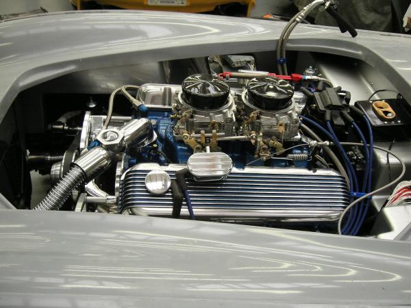

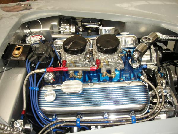

d20180 01-31-2010 01:53 AM
427 chevy
http://www.clubcobra.com/forums/pict...pictureid=2495
d20180 01-31-2010 02:05 AM
427 Chevy
http://www.clubcobra.com/forums/pict...pictureid=2496
d20180 01-31-2010 02:10 AM
427 chevy
http://www.clubcobra.com/forums/pict...pictureid=2497
d20180 01-31-2010 02:12 AM
http://www.clubcobra.com/forums/pict...pictureid=2498
d20180 01-31-2010 02:14 AM
http://www.clubcobra.com/forums/pict...pictureid=2499
Lightingrod 01-31-2010 02:16 AM
NICE!
Al
MotorcityCobra 01-31-2010 03:39 PM
Excellent job with the engine compartment. I'm saving to use as a goal for mine.
