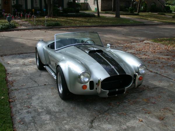

JEwalt 06-21-2010 09:57 PM
Phoenix from the Ashes
Kit purchased 1996; completed 2000;
http://www.clubcobra.com/forums/pict...d=3581&thumb=1, http://www.clubcobra.com/forums/pict...d=3580&thumb=1' http://www.clubcobra.com/forums/pict...pictureid=3582
Damaged 2003; stolen July 2009; recovered 1 week later totalled.
