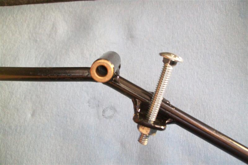

Should there be a bump stop for the gas pedal arm so that it does not go all the way back and hit the firewall?

Should have some type of throttle stop that you can adjust.

We use a threaded adjustable stop to stop the arms getting cranked around on the shaft.

CR's have a proprietary pedal box with a plate for the pedal stop built in. Wisconsin snake needs to copy what WBulk has shown. (W.S. your pedal box is great for "heel/toe" driving if you ever get into racing!)
