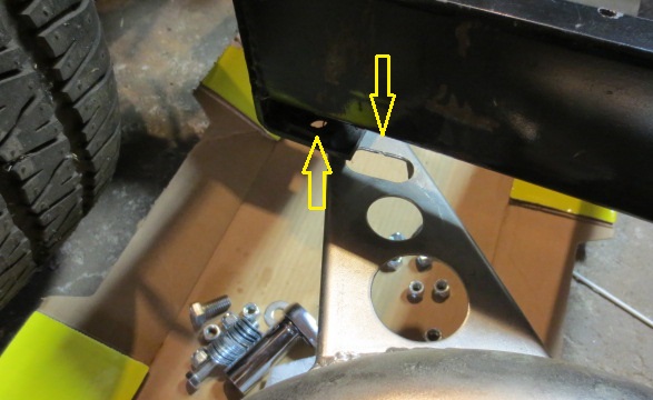

I am test fitting the sidepipes to the chassis and have come to realize that the mounting point at the backend of the sidepipes is coming up short.

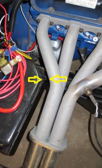

Looking at the headers, they (and engine) appear to be in the correct location as the gap between the passenger header and firewall footwell is about 1.5 inches.
http://www.clubcobra.com/forums/pict...ictureid=13769 http://www.clubcobra.com/forums/pict...ictureid=13770
The distance between the mounting hole in the chassis is 1 inch.
So the question is, do I have the engine in the wrong position? Swapping the engine mounts around would move the engine back about a inch BUT would have the engine sitting very close to the firewall AND the header less than an inch from the firewall/footwell.

I have a CR built in 1991 with a 351W. I noticed when I bought it almost a year ago that the headers were almost touching the fiberglass foot well and the pipes (where they come through the body) were resting against the fiberglass cutout. The original builder had the motor mounts on the wrong side. Changed them and the pipes moved forward 1 1/2 inches ( in the area where your arrows indicate). The pipes are also now centered in the body cutout. Unless someone has different info it sounds like you have the engine in the right place. You just need to deal with attachment at the end of the exhaust. Do your pipes have a clamp at the joint of the muffler/header? If not a piece of flat stock could be used as a joiner at the attachment point.
HSC-ZL1 06-04-2015 12:19 PM
Your picture of the frame mount and turn-out bracket should be fairly easy to get some kind of vibration damping and bracket to mount. If you have a friendly exhaust shop nearby they might have something that could bolt right up with a piece of flat stock or even a complete hanger.

The clearance between the headers and firewall looks OK to me, but do the headers line up to the cut out in the body? That would be my biggest concern...there are ways to realign the side pipe mounts, but cutting (or worse patching) the fiberglass is a lot harder.
For the side pipe mounts, you could use a rubber (or silicon) mount at the frame mount and weld the mounting bracket to the existing bracket to your pipes. (See link for example)
http://www.summitracing.com/parts/stw-uh3-5w/overview/
Another option would be to cut out the restrictive mufflers from the side pipes and replace them with more free flowing ones. This would give you the chance to adjust the overall length of the side pipes.

I think I am going to get some angle iron from the hardware store, cut two 3 inch sections (one for each side) weld a nut on each one for a mounting point. Then weld it to the side of the chassis effectively moving the mounting point forward to where it lines up with the side pipe.

I found having a threaded stud fixed to the frame made attaching the sidepipes easier to line. You could make an adapter plate to connect if its necessary.
