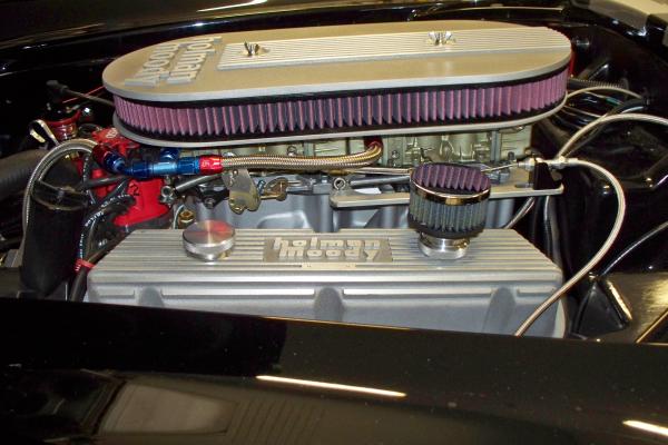

colubra 07-28-2015 04:26 PM
2 Attachment(s)
these pictures will not probably tell you much about the set up but any
comments would be welcomed.
wkooiman 07-28-2015 06:02 PM
That's the common thought, but that's not correct.
As long as you use vacuum secondary carburetors and progressive linkage, 2 Holley 600's will work perfectly fine on a 302, non-stroked, street engine.
But you are really only gaining the visual impact.
Think about how they work. The vacuum secondaries will only open if the engine needs it, so on a 302, they will usually be closed. So, you really just have a 600 double pumper, running off the front 2 barrels of each carburetor.

wkooiman 07-29-2015 08:55 PM
That pic doesn't look like Holleys. That looks like the 2x4 intake that will only fit Edelbrock carburetors. I can't tell for sure with the air filter.
And you have many more options than that. The safest bet, in my opinion, is to get a high rise dual plane with a single 4-barrel Holley-style carburetor. It is easy to set up, and it will run well. You can do a double pumper or a vacuum secondary. I ran a 600 double pumper on my 302 in high school, and it was not too much. With a vacuum secondary, it is harder to over carb, since the secondaries only open if necessary.
The biggest visual impact is Webers, but they cost a lot more, and they take a lot of skill to set up properly. For what it's worth, I think this website has the best Weber advise on the Internet - short of an expert like Inglese.
Or, you could do a single 4 barrel with a Paxton supercharger. Or 3x2s.
It's your car, so you need to decide what you want. But remember, if you make it complicated, it will take longer to get it right.
