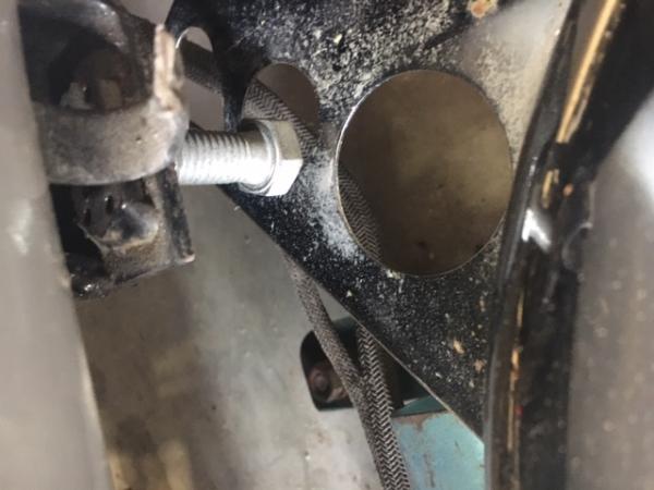

I was test fitting my side pipes and I discovered the Driver's side rear mount extends about 1" too far for the mount hole to align.
Has anyone else had this issue?
http://www.clubcobra.com/forums/pict...ictureid=18913

That sucks! Can you relocate the mounting bracket on the pipe or create an offset bracket to connect?? To answer your question though...no I did not have the misalignment. BB FE.

I ran into the same issue but on my passenger side.
I have not resolved it yet, I was thinking of elongating the hole and using a large washer/ rubber pad to make up the distance or cutting the bracket and welding where it would line up.

It turns out that I had switched the the motor mounts to the wrong sides when I replaced the original with convertible mounts to lower the mounts. Slightly lifted the motor, switched them side to side and the pipes lined up! But now I have added problem of the supercharger snout hits the hood!
