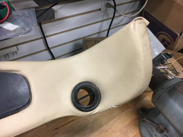

Alfa02 10-12-2021 09:18 PM
3 Attachment(s)
If I may add a word of Caution here !!! Don't use the material that came with the kit !! #1 it's 30+years old, #2 it was crap then, it's crap now !! If anyone knows of my issues with my dash pad, you will do it right once, and never has to deal with again. First use the best material you can Afford (I ended up with Leather, $250-300) Have someone that does this for a living do it (Compound Curves) and I can't stress enough, Test Fit, then Test Fit again. My car was one of the last 3 sent out (CR Series1 in 92), and we believe my dash was a "Reject" that they just threw in. Don't go though the Pain & Heartache (Not counting the Money) that 3-times was a "Charm" it took me to get right. My $.03 worth , Cheers TommyRot.

Sorry bout the pictures my computer, doesn't like our site, as you can see. We had to make a another dash over the one that came from the CR, nothing fit. If this help anyone, I can send a LOT more pictures to you if you PM me. Cheers TommyRot. P.S. the Gentleman here that did this work, will no longer work on Cobras, He said "I broke him" ;) But the complete interior came out Perfect, he is a master of his craft.
