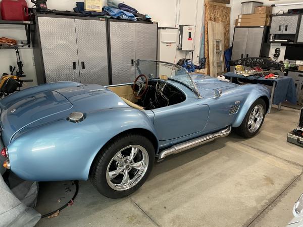

It has been a while since I have both worked on the CR or posted the status. This fall life kept getting in the way of either. Between a bit of travelling, working around the house, and severe colds 3 times (bit tired of that), I have made some progress.
I ended up selecting AR Torq Thrust M wheels in 17" so I couls get modern tires. http://www.clubcobra.com/forums/pict...=21413&thumb=1
I finished the wiring (I think) and cleaned up the wiring harness under the hood. I know it would have been a bit cleaner for the harness there if not for the EFI. But each choice has a benefit and a loss.
