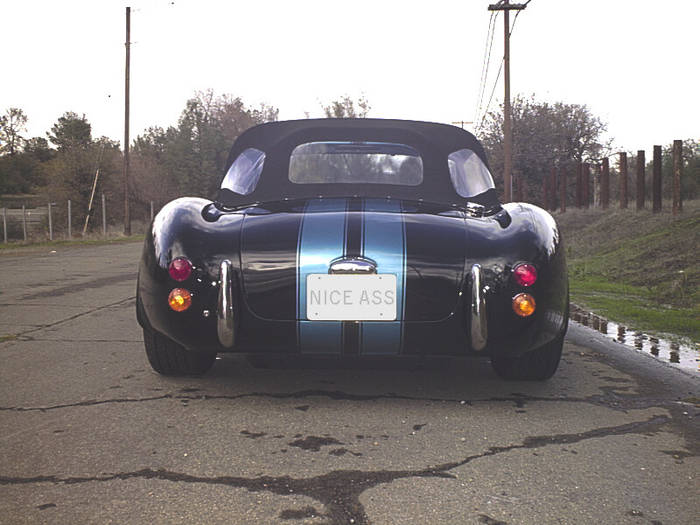

there are two bows needed to fit into the body and give the top a no wrinkeled look, plus they are needed at 'speed' or the top will just blow in the wind. The windows have a steel/aluminum frame work sewed in so they too will retain their shape. Each window has a marine "plastic" zipper so that they can be opened. The windows, sides and the three in the back are of top quality marine visqueen. The tops Don provided were first class and I assure you these will have to be done as or better than the originals.

Ital-cobra 03-12-2008 10:05 AM
Here's a rear view of the top hope this helps.
