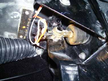

onefastmustang 08-08-2009 11:47 PM
I will see if I can take a picture for you in the morning, if someone doesn't get to it before me.

NAPA switch part number
Don Scott sent me NAPA part number SL-169 for my CRII.
Below is a photo of mounted switch. Hard to see, but he switch has a metal flange that goes on the pin of the brake pedal BEFORE the spherical rod end (which screws on to the brake booster rod). I think the pivot bolt for the pedal has to go in last to permit assembly. Real fuzzy on remembering, exactly.
The "slop" or "play" in the fit of the spherical rod end and the pin on the brake pedal provides the movement to actuate the brake switch. Having the switch in your hand would make it easier to understand how it mounts and functions.
Apologies for the poor photo. Wow. does the dust show up when you take a photo!

onefastmustang 08-10-2009 02:16 PM
that sounds like the same one I had. I have yet to get the car in a position where I can take a picture with a back brace one.. :( Soon.

onefastmustang 08-10-2009 11:14 PM
Actually I took a pic after I had my wife put the cobra up on my four post lift.. :)
http://pic100.picturetrail.com/VOL11.../371648173.jpg
Double Venom 08-11-2009 02:06 AM
OFM,
May I ask what is the third wire (purple) for? Actually, by the picture it almost looks like the white would be the #3 wire?

onefastmustang 08-11-2009 07:39 AM
I will have go back out there an crawl in and look.. Once my coffee kicks in I happily will. :)

onefastmustang 08-11-2009 08:46 AM
Oh it was no big deal.. the cars up to my head level almost.
Now I remember where that wire goes. Since both sets of lights on the back have two circuits I used the second circuit in the yellow lights to come on when you hit the brakes. It's just a splitter on the switch and then the second wire run to that circuit. Makes for a bright and attention getting braking. Can you tell I have been rear ended a few times, 7 to be exact.
