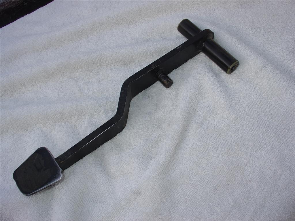

http://www.clubcobra.com/photopost/d...219_Large_.JPG http://www.clubcobra.com/photopost/d...222_Large_.JPG Ok, got the brake pedal modified. If the pictures (before and after) don't show up here they are in my gallery. I re-installed the pedal in a lower hole on the pedal box, the MC rod position did not change nor did the pedal pad height. However the depth of the pedal in relation to the other pedals has changed with it being in a more depressed position at rest. I am not able to correct this because I have no adjustable rod on the MC, and was unable to remove it from the MC piston to change the length.
In flushing the old brownish orange hyd brake fluid I found a lot of gunk and sludge in the MC and so I removed it and cleaned it thouroughly. BTW it's 15/16" bore. I re-assembled and flushed the brake lines starting with the passenger side rear, driver side rear, passenger front and then driver front. I have clean clear fluid throughout. Now pressing in the pedal I feel that there is hyd pressure again, but the pedal does not feel completely restored. It does not return as crisply as I think it should. It feels kinda dead.
Thoughts on this please...do I need to purge more air that is still in the system? Do I have some other foreseeable problem like bad springs in the brakes? Disc front, drum rear. I'm not really sure what causes the pedal to return.
Thanks, John
mickmate 03-14-2010 08:55 PM
It should be pulled back by a spring not just rely on hydraulic pressure. The main reason to pull it back fully is to expose the port allowing the brake fuid supply in to the master cylinder. Any kind of a good extension spring mounted out of the way of your feet should do it.
bobcowan 03-15-2010 06:39 AM
Yes, use a light spring to bring the pedal back. But, make sure that there is a return stop so it doesn't get pulled back too far. It sounds like it won't pull the rod out of the MC. But it will create a dead zone in the brake pedal.

http://www.clubcobra.com/photopost/d...225_Large_.JPG Reporting in...MaSnaka has brakes! For those who have been following I hope this is the end of my saga. I replaced the MC. I took the old one to the local NAPA auto parts store and the nice folks there were able to cross reference the part number and find a replacement (made in USA). It is from a late '70s Mustang II. I paid $75 for the new one. There were instructions on bench bleeding which I followed and the install was a snap. I replaced one of the 3/16" brake lines that had a bad fitting, NAPA has them already flared in a variety of lengths, 12" long for about $3.50. I modified the push rod to make the length adjustable for the perfect pedal height (picture included). I have noticed that with every little change there comes a handful of related project tasks. After spending days/hours working on this I am able to say changing my pedal ratio made a big difference (that was great advice). So far I have about $200 in this total with the pedal mod and new MC plus incidentals. I still plan to upgrade pads, resurface discs and clean and lube. Today was a day I could actually get my tires to lock up at about 45-50mph. I still look forward to a total four wheel disc upgrade (when my stimulus check arrives) but for now it's good enough to stop as one would expect. For some reason my brake light switch lost power, it never ends...Thanks you guys for the help and support.
