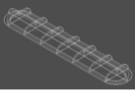

WCC Chassis 3299 - CNC machined grills
Now that the body work was making good progress in 2014, I still did not have the traditional brake cooling inlet grills, oil cooler inlet grills or the main radiator grill. So after scouting ebay and this forum I was not successful. So with the help of a tool builder and expert machinist we designed them based on my body opening dimensions taken off the car. This is my point about feeling like a scratch build some days:D:D
http://www.clubcobra.com/photopost/d...ate_1_inch.jpg http://www.clubcobra.com/photopost/d..._mastercam.jpg http://www.clubcobra.com/photopost/d...oler_Grill.jpg http://www.clubcobra.com/photopost/d...sh_grill_1.jpg http://www.clubcobra.com/photopost/d...air_grill3.jpg http://www.clubcobra.com/forums/pict...=13285&thumb=1 http://www.clubcobra.com/forums/pict...=13286&thumb=1
Here they are fitted to the car after paint. Superb!
But after writing the program and surfacing the radiator grill we learned it will take 44 hours on the Haas machining center. So to this day that grill project is on hold. My friends were not able to free up hat kind of time without charging for that time. Who kmows maybe I will decide to AM the part from powdered aluminum metal ? We’ll see.

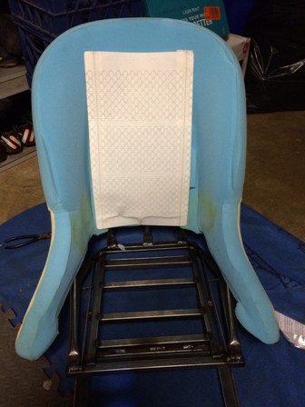

So after fruitless attempts of buying the interior from the now defunct WCC in winter of 2015, the car sat for over a year. I was over budget, way over budget after the body work so decided to design and fabricate my own interior. Ive never tried this before. “Look Mom..... no hands”. I watched alot of you tube on interior builders with alot of experience. I then found an interior material supplier that made it easy to buy the stuff I needed. The seats were the easy piece. Purchased Cobra branded seats from England using Factory Five. Simple. Then I disassembled them to install the heated seat elements
http://www.clubcobra.com/forums/pict...=13288&thumb=1
Aftermarket heated seat kits made it easy to incorporate them into my build
http://www.clubcobra.com/forums/pict...=13290&thumb=1 http://www.clubcobra.com/forums/pict...=13289&thumb=1
