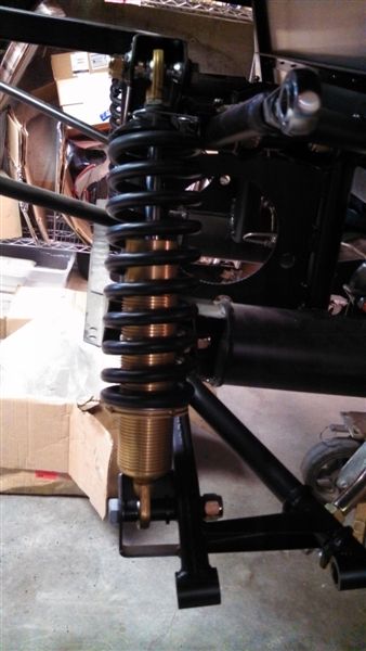

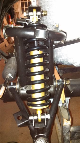

ScratchBuilder 11-26-2014 11:02 PM
Thanks to the CC member who pointed out that Acton Custom had installed the rear springs on the front of the car:
http://www.clubcobra.com/forums/pict...ictureid=13103
And the front springs on the rear:
http://www.clubcobra.com/forums/pict...ictureid=13102
You can also see the rubber bumper on the shock in the wrong spot.
SB

Three Peaks 11-27-2014 08:55 AM
SB
May or may not be true. With my QA1 springs, that is how they are mounted also due to the fact the springs for the rate I was seeking are only available in certain lengths. Those springs are probably mounted in the correct position if you check the spring ratings.
However, Jamo has made a great suggestion and I hope those involved take heed of it. Thanks Jamo.
