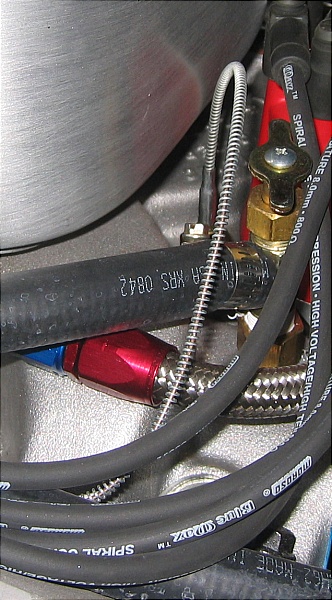

Mechanicals generally have a tube that is protected by spiraling wire that looks like this:
http://www.clubcobra.com/photopost/data/500/mech001.jpg

yep, that's what i got. word is that it is probably shot. after some research it seems they are not that dependable. i have a supply just down the road here in south minneapolis. 135 for a new one. damn.
