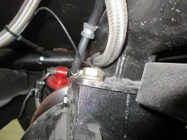

jrbruc84 09-02-2015 04:07 PM
Diff mount plate 4 bolts
http://www.clubcobra.com/forums/pict...=14063&thumb=1 http://www.clubcobra.com/forums/pict...=14064&thumb=1

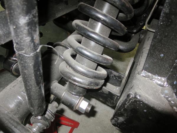

jrbruc84 09-02-2015 04:24 PM
Dan, I just posted a photo of the differential mounting to a plate on chassis. I do not have the carriage nor does it have the drag rods connecting the hub to the chassis, only a bolt on stopper that bolts to each drive shaft with two u bolts. It is about 3 inches long with a metal plate on the end an butts up to the frame. Each end appears equadistant to the frame. See the next photos. Would a bad or out of adjustment shock absorber cause this? I say this becuz if there are two shocks and one is set hard and the other soft, would that cause the up and down movement to twist diagnally instead? Rick makes good suggestion with the spacers but I really would like to find out what is causing this. I have 15 inch tires. The rubbing occurs over bumps or turns.
jrbruc84 09-02-2015 04:51 PM
http://www.clubcobra.com/forums/pict...=14066&thumb=1 http://www.clubcobra.com/forums/pict...=14067&thumb=1
RICK LAKE 09-02-2015 05:13 PM
you are giving more info
jrbruc84 Is it Bruce? If this is only over bumps, replace the shocks, but I don't think this will fix a body hitting problem. It's a tire rub. Put 1 thin spacer in the r/s of 1/8" I think that will clear the tire. The other thing is we don't know what the rear camber reading are? You might only need to add shims to the r/s drive shaft to help clear the body. Was the rearend apart? They might have not reinstalled all the shims and this will cause the same problem. Call me in the about 3 hours. Rick L.
