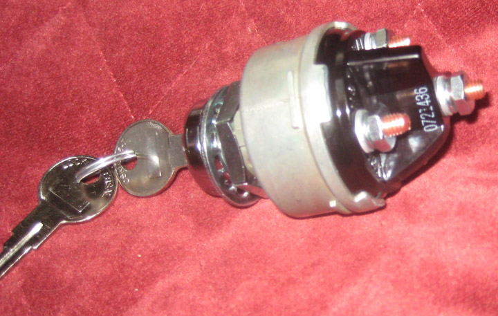

Mine went bad too. It's a “Universal Ignition Switch” ACDelco Part #D1460 (#12339178) but with a custom bezel. The bezel actually costs more than the switch.:p You have to file down the bottom of the porcelain "triangular" separator for it to fit behind the dash lip. Other than that, pretty straight-forward replacement. I've had no problems with the replacement; the original was twitchy from the get-go.

Some pics...
Note the filed down insulator.

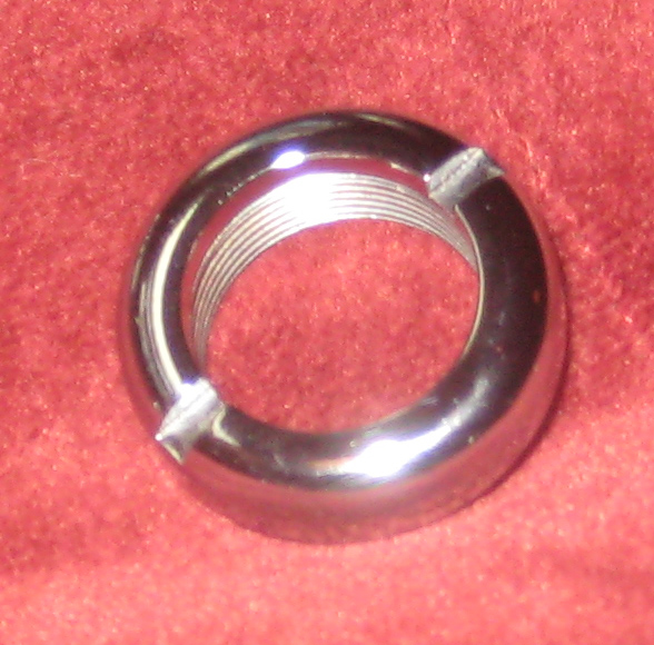

And the beautifully crafted bezel.
Huh. Don't suppose that's a 1/2-20 thread?
patrickt 11-27-2009 02:10 PM
I'm not sure what the thread is, but if your car didn't come with it, and you want it, just give Bob P. a call. It's probably $50 or so I'd bet.
Gunner 11-27-2009 10:31 PM
No, I have the correct piece. I'm thinking it would make a dandy gearshift knob locker if it's the right thread. :)
strictlypersonl 11-28-2009 05:38 AM
Unfortunately we have to rethread the switches to match our bezels. :CRY: The switches that the bezels were designed for are no longer available so we were put into the situation of having a pile of bezels that had become expensive ornaments. Fortunately, it's not hard to rethread the switches, which is our situation now.
