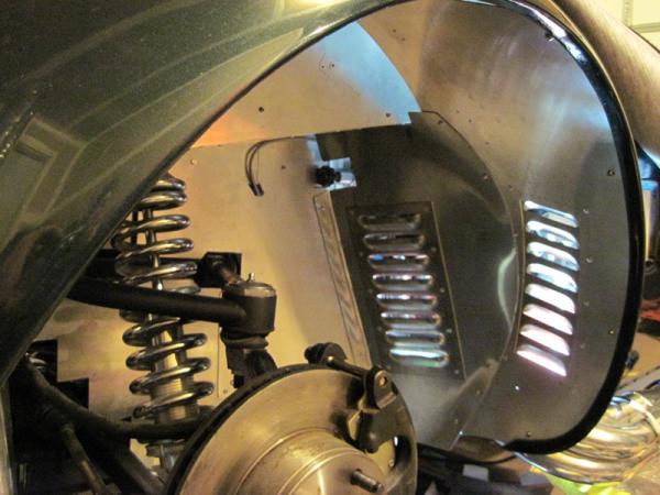

Xack 05-09-2015 07:22 AM
Louvers
You can purchase louvers to fit in the area to keep dirt from being thrown up onto your headers and route the air to the vent.
This example is for a West Coast Cobra. It did not have any fender wells at all. As you can imagine, dirt would go everywhere. You should be able to add the louver from the back side on three holes drilled to match your vent hole pattern.

Large Arbor 05-09-2015 04:59 PM

davids2toys 05-10-2015 09:58 AM
http://www.clubcobra.com/forums/pict...pictureid=7331
Interesting idea for sure. So this is two sets of louvers you have, 1 set facing up, 1 set facing down?
I have not installed the screen yet so I have no holes to worry about, just the heat shield locating holes.
Do you have dimensions for the louvers and maybe a link. They look quite a bit smaller than the screen. Perhaps I could use this instead of the screen. Paint it black, it will blend right in!

Xack 05-11-2015 11:04 AM
Louvers
You can have these Louvers custom made to match the pattern of your hole in the wheel well. I bought these louvers to place them in 2 positions. 1 as far back into the wheel well and I mounted it on the outside because there is no interference with the tire. 2. The one outermost has to be mounted inside the aluminum panel to avoid tire interference. The tire will kick up dust and debris so they should vent from the top down and block dust, dirt and rocks being thrown up from the tire tread. This along with your screen, should keep the footbox and header collector clean longer. You can mount them on the inside on top of the screen. I did not use a screen, because that'll just get clogged with mud. Mine is a West Coast Cobra. It has no wheel well material at all. The aluminum you see in the photo is non-standard. I have no heat shield. I think I may need to look at making one.
