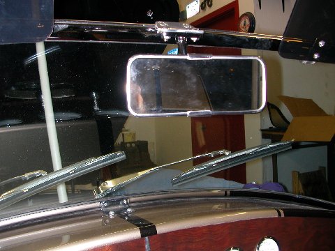

you could mount a second dash mirror on the windshield and turn it to the blind spot. Someone on FFR site sell them or you can make one of of aluminum.
http://www.clubcobra.com/photopost/d...32resized1.jpg

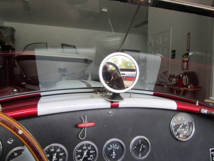

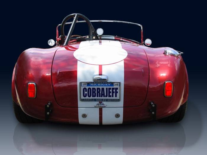

cobrajeff 12-30-2013 05:37 AM
Mirror, mirror....on the dash......
I love the racy look of the Raydyot mirrors, but they aren't real practical out on the road. I have three of them spread across the dash, but they have a limited field of vision.
http://www.clubcobra.com/photopost/d...m/DSCN6747.JPG http://www.clubcobra.com/photopost/d..._3128_copy.jpg
A few years ago at Concorso Italiano, I discovered Aardvark International - the US distributor for Talbot mirrors. They had convex elements for round Talbot mirrors that I installed in my Raydyot mirrors.
These were a little smaller in diameter, but they will fit in the Raydyot housing. Talbot & Co.

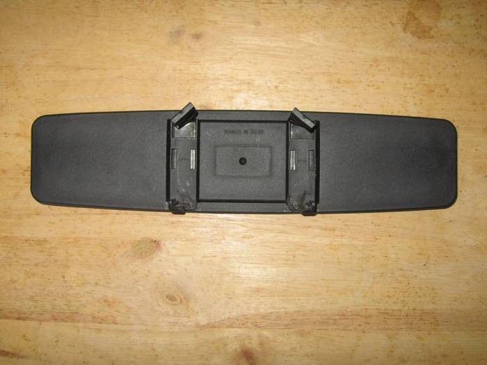

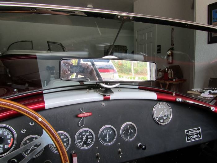

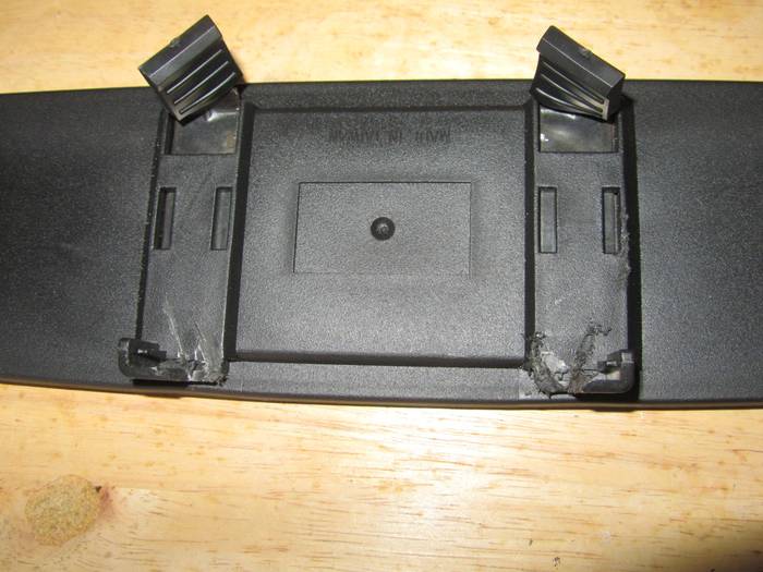

More recently, I purchased a clip-on CIPA mirror at Summit Racing, and modified it to work with my Raydyot mirror.
http://www.clubcobra.com/photopost/d...m/IMG_6606.JPG http://www.clubcobra.com/photopost/d...m/IMG_6608.JPG
The CIPA mirror has two plastic fixed posts, and two spring-loaded metal posts. I trimmed the plastic posts to reduce their width, and then bent the metal posts at an angle so they would clamp on to a round mirror.
The results are great - I can drive with this clip-on mirror in place, and when I get to a show, I just pull it off. Affords a much better view of what's behind you. http://www.summitracing.com/parts/cip-34000/overview/
http://www.clubcobra.com/photopost/d...m/IMG_6609.JPG http://www.clubcobra.com/photopost/d...m/IMG_6615.JPG
