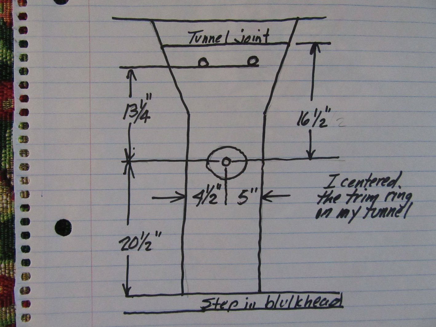

I'm curious as to how the TKX will sit. FWIW, here's how I have my TKO aligned.
http://38.134.118.239/shifter001.jpg
TKX shifter stub is in the same position as TKO.

patrickt 01-25-2021 05:00 PM
It's working, but if you scale them down to like 600 x 800 you could embed them directly for ease of viewing.:cool:
https://thumbnails-photos.amazon.com...r1OEm0iAwMPnty
patrickt 01-25-2021 05:13 PM
This is 600x800 and directly embedded for ease of viewing.
http://38.134.118.239/test001.jpg
