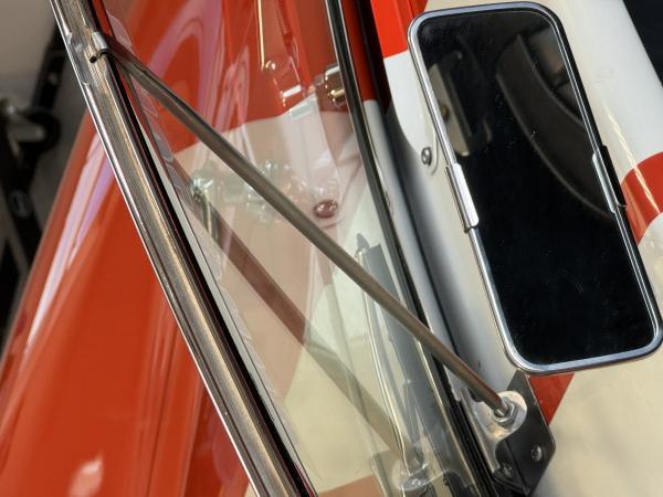

Last month we drive 838 from Indy to the coast on Route 66 and up the PCH. It was about 6000 miles and a lot of that with the top.
I noticed evidence of the windshield frame spreading apart and decided to add a windshield tensioner. There are many photos of original Cobras and MGs with them. I copied one of the Cobra photos.
It turned out quite nice and cost $6 for stainless plate and a rod.
John

John, I’ve had that happen on my car too. How does the tensioner attach at the top? It kind of looks like it just hooks over the frame? I have one of those little Beclawat plates riveted to the inside of mine in the center which I hate to remove.
Grubby 08-20-2024 10:05 AM
It is a flattened J hook at the top. I saw one photo with the Beclawat logo and the J hook went over it.
The short end of the J has to be short enough to clear the rivets in the headers.
John

John, how did you manage to remove the screws at the lower windshield frame to install the lower tensioner rod bracket? I suspect you’re going to tell me you unbolted the windshield, and raised it up and tilted it forward some.
Grubby 08-25-2024 12:02 PM
I did remove the windshield. The screws into the bottom frame had pulled partially out so I had to get access to repair the threads.

Dang, even with the extreme offset screwdrivers I bought I can’t get a good enough bite on those screws without risking a slip and scratch getting them out. I measured my windshield angle and it’s 42 deg off horizontal which is the lower end of what is usually seems to be used (42-45 deg). I may try making a bracket that secures to the center bracket screws that go into the cowl instead. It may be a little clunkier but at least I wouldn’t have to disturb the screws into the windshield frame.
Grubby 09-02-2024 08:31 PM
ERA set my windshield angle, as they fitted the top.
My windshield frame had much of the threads pulled out. It was easier to fix that off the car.
John
