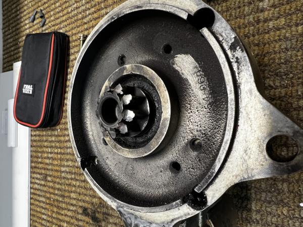

Well crud. I pulled the starter. I don’t think it was still engaged with the flywheel, but the pinion gear is all chewed up, see picture.
http://www.clubcobra.com/forums/pict...ictureid=21406
So I definitely need to get the starter and solenoid tested. And need to replace the pinion gear.
The flywheel feels a little rough, but is not chewed up like the pinion gear.

1795 01-01-2025 05:23 AM
Based upon the limited view of the teeth on the starter gear, it looks like it may not have been properly aligned when installed and was not kicking back far enough. Are the teeth showing signs of wear further back? It looks like the ends were chewed off, which would suggest that it was only partially engaging and that is why they were torn off. It's hard to tell, because there is not a good view of the teeth further back to see if they are shiny.
@1795 I think you’re right Here are a couple of better pictures that make it look like the pinion gear was only engaging about half the way with the flywheel. Once I get the new parts, is there an easy was to adjust the engagement depth of the pinion gear?

TKlauber 01-02-2025 06:38 PM
I had somewhat of the reverse happen with my starter on my FE 427 SO. The starter is similar to the one on Patrick's Cobra and the pinion gear was travelling too far into the flywheel and the face of the bearing was getting chewed up fairly quickly. I put a round shim in to move the starter out away from the flywheel
