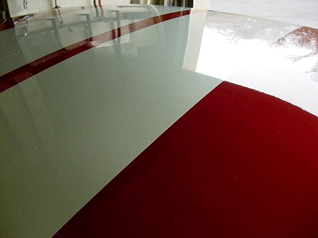

Rich10 01-16-2008 06:11 AM
Beautiful ERA in progress
I spotted this outside Metal-morphous Friaday and downloaded a few pictures from there site, beautiful cobra and love the colors
[IMG]http://www.clubcobra.com/photopost/d...0/MVC-045S.JPG[/IMG]
[IMG]http://www.clubcobra.com/photopost/d...0/MVC-041S.JPG[/IMG]
[IMG]http://www.clubcobra.com/photopost/d...0/MVC-037S.JPG[/IMG]
xracerbob 01-16-2008 05:27 PM
That's Fred's car. That will be one stunning ERA when finished. Mine's at MM as well getting prepped for paint. Can't wait to see the final results.

fkemmerer 01-17-2008 10:28 AM
ERA in Progress
Thanks everyone for the nice comments! Ron deserves all of the credit here. He has really done a fantastic job with the paint and body work on my ERA. He's also been a great source of advise on how to approach all aspects for the project.

fkemmerer 01-19-2008 09:42 AM
Attached are a few more pictures of the work that Ron did on my ERA. I would highly recommend Ron for high quality paint work. I have not seem anyone do a better job than he does on a fiberglass car!

patrickt 01-19-2008 09:53 AM
Jeez, that's "rocket ship" technology compared to mine. Absolutely gorgeous -- we'll all be interested in a road test report on how that traction control system performs as well.
