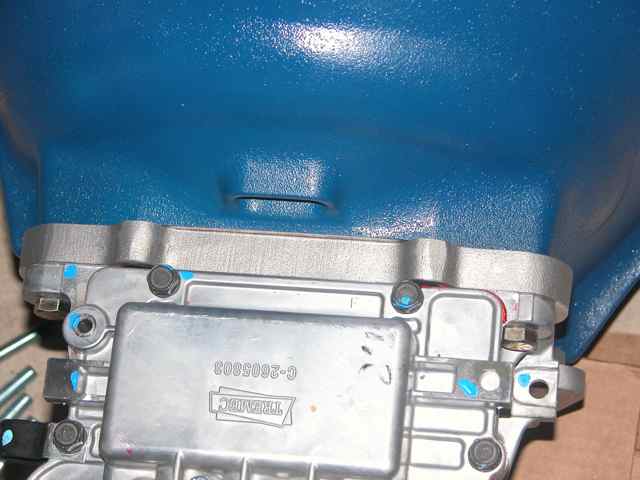

428street 09-07-2008 02:00 PM
ok, back from the garage.
I definitely did not mess with the circumference of the bearing retainer, just the surface of that. Once I filed down the numbers and the bottom boss a bit the space went on like a charm with a slight wobble.
I rechecked the distances per above and I was off. I also had a buddy come over and we did a mock up of the install out of the car and everything fit nice and tight with the spacer, etc. The tail shaft fit nicely into the pilot bushing with about an 1/8 sticking out (or visible) between the pilot shaft and the spline part of the tranns.
I'm going to call doug but I think I'm ok. My buddy who came over built his ERA FIA so he has a bit more experience then me and he said it was fine.
428street 09-07-2008 02:15 PM
http://www.clubcobra.com/photopost/d.../DSCN00073.jpg
http://www.clubcobra.com/photopost/d...DSCN001011.jpg

Jim Holden 09-08-2008 06:49 AM
Just to clarify; we ground off the casting numbers, clearanced the spacer plate where the bolt heads of trans, bearing retainer interfered, as well as slightly knocked off the sharp edge of the cast steel bearing retainer so that the plate fitted flush to the face of the transmission. If you hold the plate to the trans. surface and look through the opening, you should see where it interferes.
...and as I indicated above, we cut off a little of the end of the shaft to be sure it didn't hit the end of the crank.
Jim
