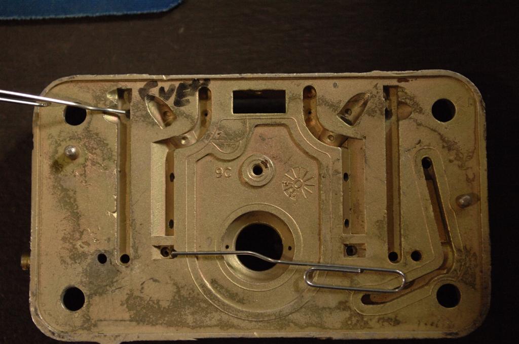

Tom Kirkham 11-20-2009 12:57 PM
Originally Posted by cdnus (Post 1002693)
Tom,
Perhaps when you have a little time, could you please post more info on how to alter with expected results the transition circuit.
A few photos would be greatly appreciated also, for the carb challenged.:confused:
Craig
Sorry to have taken so long to post the pic.
http://www.clubcobra.com/photopost/d...19_Large_1.JPG
In this picture I have put some paper clips pointing to where the idle restriction is. Please note: that Holley only uses one or the other location as a restriction, not both. Typically there is a brass slug that has a calibrated hole. This restriction controls your idle/transition circuit. You will need a number drill set and a pin vise. Measure the diameter of the hole before you start so you can go back...
http://www.mcmaster.com/#metalworkin...d-rods/=4l7tlr
drilling the jet bigger makes the circuit richer. Go in small steps...
Please note: that I only put pointers on one side of the block. The right hand side has the same restrictions.
As a side note: I have never seen this circuit too lean from Holley...
Tom Kirkham 11-20-2009 01:17 PM
The idle circuit is what determines for the most part what your fuel economy is at cruise. This circuit can be made quite lean. For example an air fuel ratio of 15:1 is not uncommon at cruise in modern engines. Please note: your engine will not be happy at an idle with an air fuel ratio this lean.
We have one of Keith Craft's 482 getting 15 MPG on the highway, with outstanding driveabilty. It just takes time... and a wide band O2 sensor.
cdnus 11-20-2009 02:31 PM
Thanks Tom,
Not long at all.
I can achieve any A/F @ idle I want with the scews, but when I have it in a reasonable range 13.5-14.7 the cruise ( below 22-2300 ) will run as high as 16+. I keep tabs on the plugs & everything looks ok, pretty white but ok. As soon as I apply a little throttle it picks right up 13.5-14.5. The richer I run the idle the better the cruise is, But as you know there are limits to that.
Your mod--will it richen up & change the idle adjustments also, or will it just help out the transition?
I have 18000mi on the engine & get 22 MPG average.
Thanks again
Craig
Tom Kirkham 11-20-2009 02:58 PM
Originally Posted by cdnus (Post 1002907)
... Your mod--will it richen up & change the idle adjustments also, or will it just help out the transition?
Craig
Yes it will change both the idle and transition. So you will need to readjust your idle screws. Those are very impressive MPG numbers.
