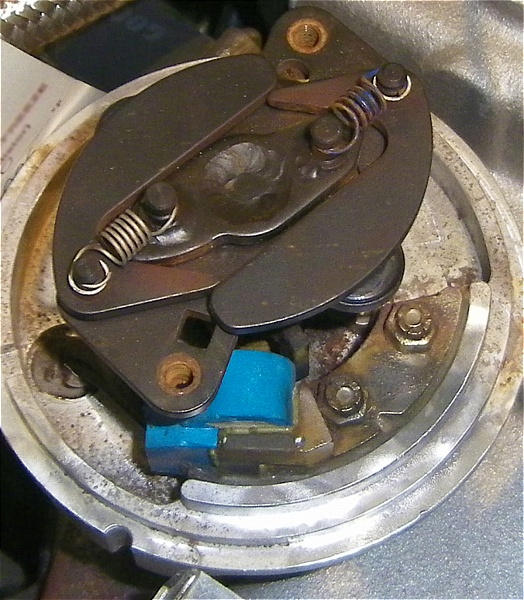

I run the light silver and blue combination, along with the silver bushing (25 degrees). I have 10 degrees initial, 35 degrees total. There's a shot of my curve below. It works very well, and the modest initial timing makes cranking easy.
http://www.clubcobra.com/photopost/d...springs001.jpg
http://www.clubcobra.com/photopost/d...utor_curve.jpg

FWB 06-23-2010 05:28 PM
and your distributor doesn't look rusty anymore........
mines out and i just keep staring at it on the bench.........maybe it'll fall on the floor and break so i can buy something else. :D
Gaz64 06-23-2010 05:30 PM
Patrick,
I'd be lubricating that advance mechanism, red dust from dry pivots.
patrickt 06-23-2010 05:33 PM
I spent some time on it with a little brass brush in my Dremel tool. I was going to do more to make it better, but........
Originally Posted by Gaz64 (Post 1060427)
Patrick,
I got side-tracked by my exploding harmonic balancer (well, it didn't explode, but it did come apart). I do need to do more work on it, that is true.
