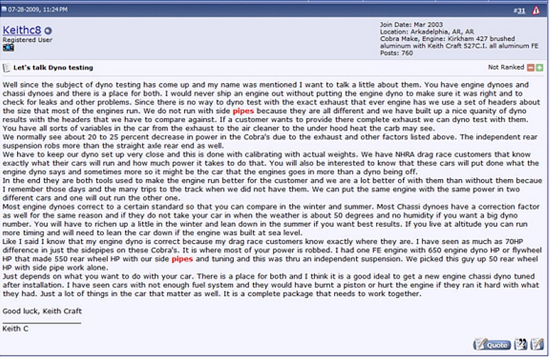

patrickt 12-01-2010 04:17 PM
Uhhh, 20 to 25% Please...
This seems to be a pretty authoritative post.
http://www.clubcobra.com/photopost/d...0/keith001.jpg
RodKnock 12-01-2010 04:23 PM
Uh, so, what's your point? There's nothing new here. No new ground covered.
I see something that says sidepipes are the biggest power robbers and I had mine cut off and replaced with allegedly higher flowing/less restrictive pipes.
patrickt 12-01-2010 04:28 PM
Originally Posted by RodKnock (Post 1093460)
... I had mine cut off and replaced with allegedly higher flowing/less restrictive pipes.
But you didn't have the numbers checked. That's unlike you to just take a set of numbers "on faith.":p Uhhh, what do you think those horsepower numbers for a 610 engine less 25% turn out to be?:p

So, as I questioned Sharapa in his dyno thread, the parasitic losses are no where near 26% as you're preaching to Rod and less than the 22% he and his friends have seen.
My numbers work out to 17.5 to 18.5% consistently. And the local IRS Cobras I've seen are comparable. A live axle car may be less-the big transmission gears in Richmonds and TKOs can add to loss -so we can only generalize.
