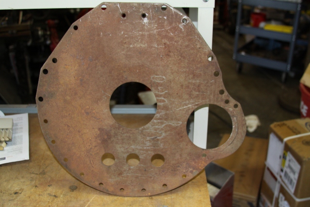

http://www.clubcobra.com/photopost/d...2_640x427_.jpg

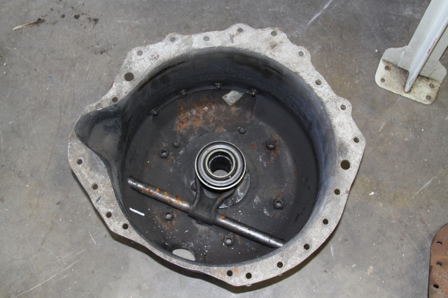

This is a Lakewood block plate for a Ford big block--notice the number of bolt holes around the outer edge and also the 3 holes for air and the starter pocket ring.
Jerry Clayton 04-29-2011 06:36 PM

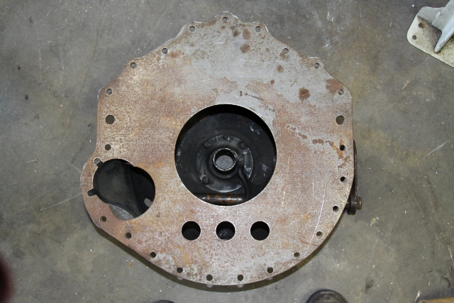

http://www.clubcobra.com/photopost/d...0_640x427_.jpg
This is the block plate for a Chev--notice the same setup as for extra bolts as the Ford. It is also laying in place on the Lakewood
Jerry Clayton 04-29-2011 06:46 PM

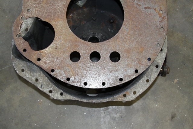

http://www.clubcobra.com/photopost/d...6_640x427_.jpg
Here you can see how the bottom was allowed to be trimmed for ground clearance and also the clutch crossshaft and throwout bearing
Jerry Clayton 04-29-2011 06:50 PM
http://www.clubcobra.com/photopost/d...1_640x427_.jpg
Here you can see just how much was trimmed and the 2 holes that were drilled for extra bolts to fit the minimun spread measurement

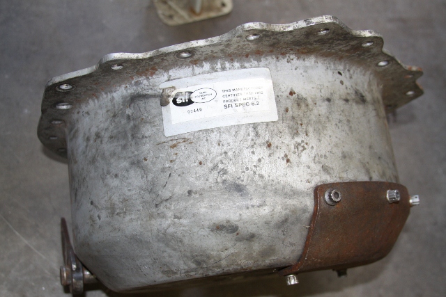

http://www.clubcobra.com/photopost/d...5_640x427_.jpg
This is the SFI 6.2 sticker that was issued AFTER the mods were done!! you can also see the cover for the hole to adjust/change clutch weights/arms/levers

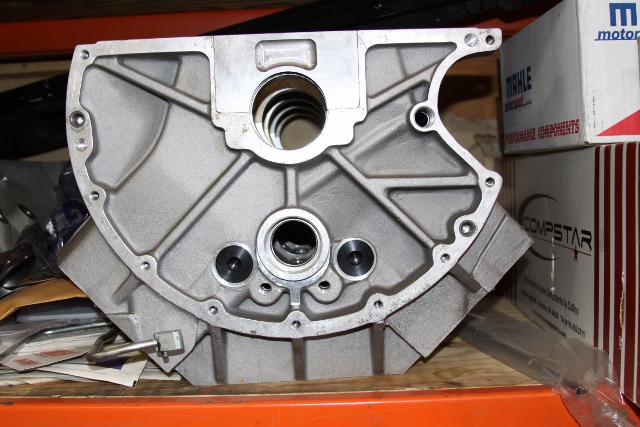

This is a rear view of a Kieth Black Hemi that shows the extra bolt holes for fastening the scattershield

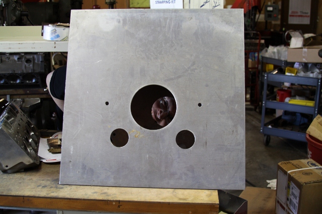

http://www.clubcobra.com/photopost/d...4_640x427_.jpg
This is a pic of the 1/4 inch 7075 t6 alum blockplate required between the engine and scattershield--visable are the 2 holes allowed for venting
the 2 little holes are for the alignment dowels in the block.

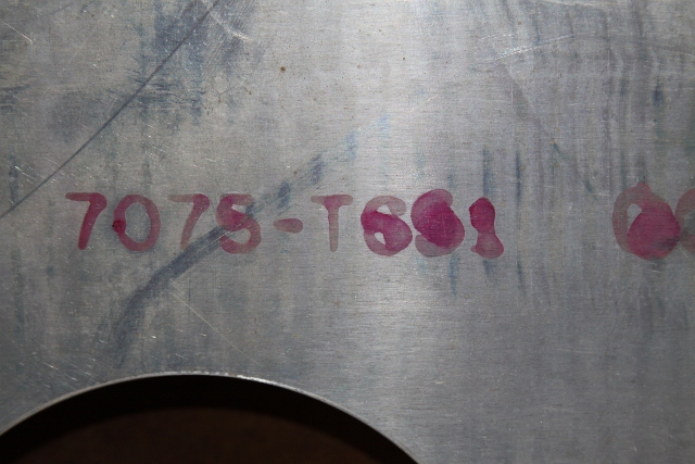

This is the alloy grade marking that can't be removed ---7075 t6
Jerry Clayton 04-29-2011 07:05 PM
http://www.clubcobra.com/photopost/d...7_640x427_.jpg
this is the thickness marking that can't be removed .250 supplier Kaiser
