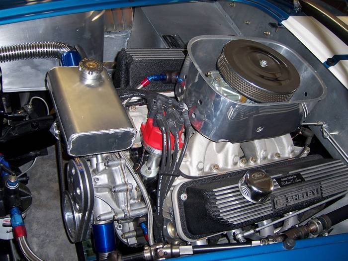

I removed my wiring loom brackets and ran my plug wires underneath to where they don't show. It looks much neater. Just be sure to cover the wires with heat resistant insulation. If I knew how to attach a picture, I'd so do. If interested, send me an email address and I'll send you a picture or check my gallery photos under "wlewis" on uniquecobra.com.

I knew I wasn't very smart, but I just realized there are pictures of my engine on this site's gallery.

From Mr. Lewis' gallery: (hope you don't mind)
http://www.clubcobra.com/photopost/d..._Wires_001.jpg
