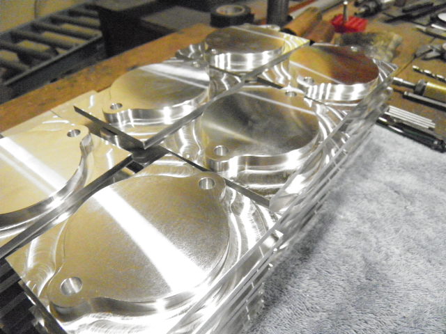

FWB 06-10-2013 10:38 AM
PhotoPost Classifieds - FE PCV Cover Plates - Powered by PhotoPost Classifieds
http://www.clubcobra.com/classifieds...e/P5170056.JPG
