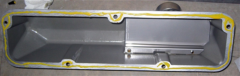

My SA FE has chrome pentroof VC's with no baffle for the single push in oil fill/breather hole. It does have a PVC valve at the rear of the intake to the carb base. Now that it has some miles on it, the blow by mixed with the valve train oil directly below the hole is making a mess. To make it worse the oil fill hole is toward the rear of the head where the majority of oil is trying to drain back.
I am asking someone to please post a picture of the underside of a baffled VC so that I can fab a baffle and attach it with some SS machine screws. Un Baffled in Ocala.

Here's mine...
http://www.clubcobra.com/photopost/d.../baffle001.jpg

Thanks Patrick. That is a good pic for me to size it up.
