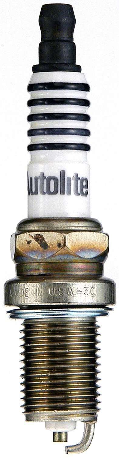

I'm thinking an open spark kernel must be a good thing or else Autolite would not modify the AR (Racing) series of plugs with cut-back (exposes the electrode) ground straps.
Autolite Racing Spark Plugs - The Best Performance Spark Plugs
https://images-na.ssl-images-amazon....L._SL1500_.jpg
From Moroso. http://www.moroso.com/sites/default/...eed%20News.pdf
