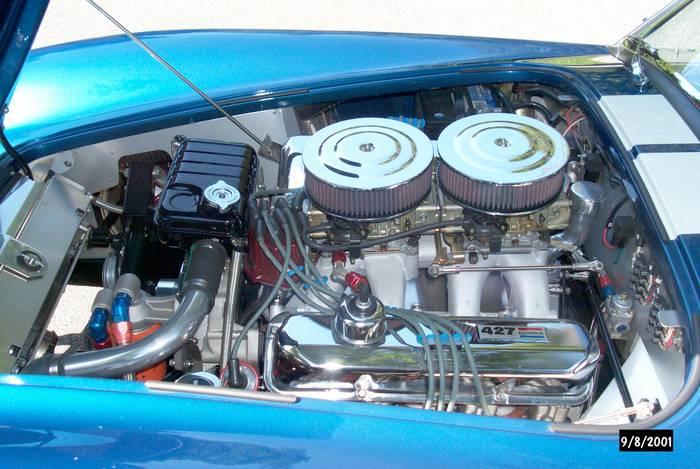

EarlsflyinCobra 07-31-2005 06:56 AM
1 Attachment(s)
A picture of my set up..................
Clois Harlan 07-31-2005 11:37 AM
Nice set-up! I modified my fuel rail so I could mount my regulator on the firewall. Everything is all done. Thanks everyone.
