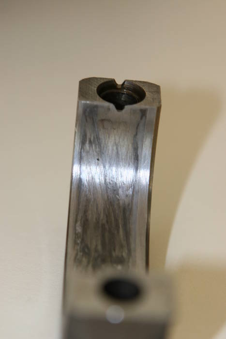

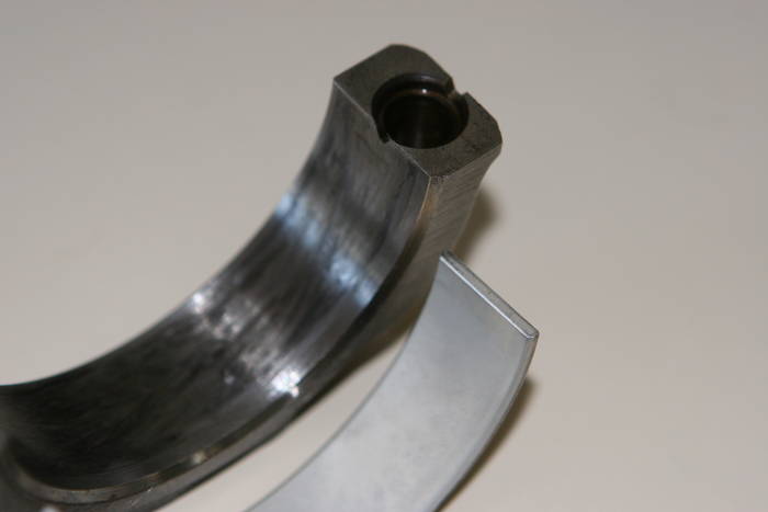

Brent Mills 03-04-2006 12:57 PM
http://www.clubcobra.com/photopost/d...m/IMG_7044.JPG
http://www.clubcobra.com/photopost/d...m/IMG_7042.JPG

Brent: Sounds like the V-notch is to match a rod or cap that has a groove across the parting line for squirting oil on the thrust side of the cylinder wall. If your caps or rods aren't grooved, the V-notched inserts are not needed. If they are and your bearings aren't notched, you can always file a notch in them. Just make sure you chamfer the edges.
Brent Mills 03-04-2006 01:04 PM
Tom, it sounds like I need them (see my pics above)? Is there a special part # or what?

I don't think those notches have anything to do with oiling....it does seem that those holes are bigger than normal - is there a locating bushing that fits in there? Are those holes larger than the ones on rods that do not have the notches?

The notches were originally put there by FoMoCo for lubricating the cylinder walls and pistons (squirt splash) with the intent to keep them cooler. It was designed to allow oil to be squirted through it if the matching bearings are used. Apparently, some bearing manufacturers decided to stop making them with squirt holes thinking it was not needed. Also, if they are used as original, it could lower oil pressure. Good Luck. :)

Did you spin a bearing Brent? That cap looks pretty rough....

Bearing cap looks OK to me, appears to be just showing the normal markings left from the old rod bearing.
