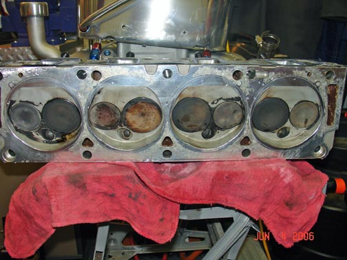

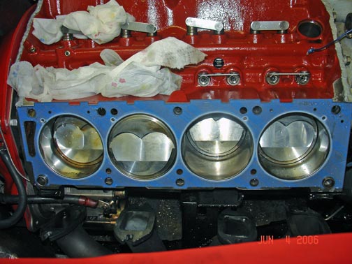

Tore it back down...here's the pics
Here's the pics of the re-tear down. Focusing on #2 cylinder as that's where the water was coming from, but did get some out of #3 and not sure if it leaked in, or ran back in the #3 plug hole when it came out of #2. Nothing obvious to the naked eye. I was noting all the residue around the #2 chamber on the head - like deposits left behind by water - and that was already there prior to this re-assembly.
Didn't appear to be the intake gasket as it was stuck down tight.
Appreciate any insights from a look at these photos.%/

afret 06-04-2006 09:09 PM
Looking at the photo of the cylinder head combustion chambers, I can't see the imprint of the metal ring of the head gasket well between #2 and #3 cylinders. I would guess the head is a bit warped and the head gasket is not sealing well in that area. Also looks like you are using the low riser Printoseal intake gaskets instead of the medium riser gaskets for the Edelbrock heads.
Excaliber 06-04-2006 09:34 PM
Well it's possible the imprint isn't there because the head is really clean in that area, I wouldn't conclude 'warped head' from that alone.
I would take the head to a machine shop and have THEM check for warpage. They will have a really long very straight 'edge' and can run a feeler gauge along it to check for clearance. You can do the same, assuming YOU have a really long really straight 'edge'.
At any rate the question now is: WHERE is that water coming from! Even a badly warped head should reasonably seal when 'cold' and 'new gasket' and prevent THAT much water from getting in so quickly. From that I would have to assume were looking for a virtual 'crater' of a gap\crack somewhere.
Even though the intake gaskets may not be totally 'correct' it appears the water transfer holes (head to block) had a good seal.
No doubt it will be obvious and simple once discovered, a kind of a "DOH" moment.
