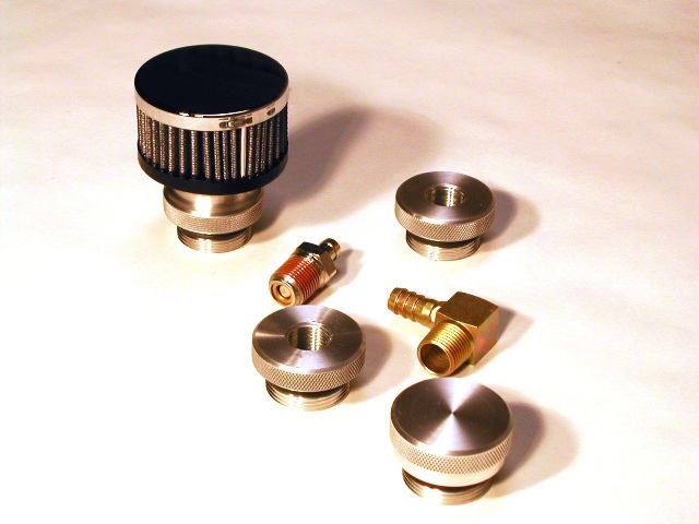

Glenn- I bought a pair of alum. ones from Summit. They said they were "polished" but, only the sides were done and I will do the tops myself this winter. The only problem is, the push in style breathers will not stay in. They are made for twist in caps. I don't really care for the "dome" style breather, I like the open air element. So, I guess I'll just weld in tubes for the clamp on breather. Question- what type are yours made for ?
FFR428 09-09-2006 01:18 PM
Kevin from what I remember they bosses are cast for the twist in style breather. But you might be able machine them for press in i'd imagine. I'm working out of state and don't have them handy. I'll have my son take some pics inside and out of each for you and Ernie. Sorry bout the delay. I bought them from Barry R at Survival. If you go to his site www.survivalmotorsports.com and click on the BT images you see the as cast finish. They are the set I bought and Barry snapped a pic for his site before shipping them to me. Overall I'm very happy with them. I had a set of the FMS polished "Cobra LeMans" covers before these. They were made for twist in breathers also. Same thing only the sides were polished and I did the tops myself. There was a bit of casting slag between the fins to cleanup also. I think the BT covers are cleaner in this area and have an overall better appearance.
G.
FUNFER2 09-09-2006 03:49 PM
The covers look great. I like that the bosses are tappet so the breathers screw in. Very nice. I did not see prices though. Any idea on the covers & breathers ?
http://www.clubcobra.com/photopost/d...Asst_small.jpg
http://www.clubcobra.com/photopost/d...alve_Cover.jpg
FFR428 09-12-2006 05:25 PM
Kevin i think they are $275-300 for the covers and breathers complete. Dennis at DSC and Carl at Carls Ford parts also have them. Barry gave me a really good price on mine so i went with him. He was under what DSC and Carls wanted. I bought the plain covers without the holes and breathers tho...
