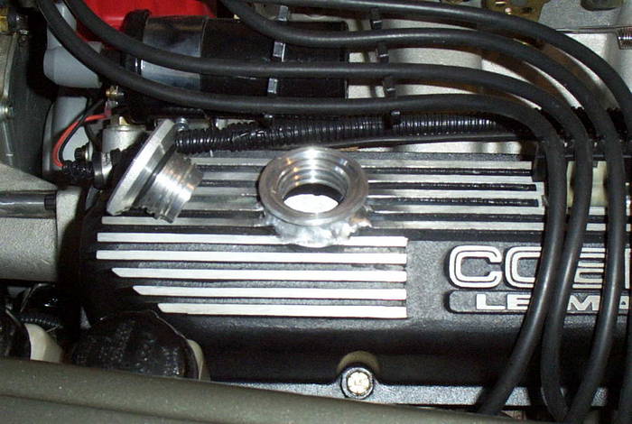

Burgs 04-04-2007 07:26 PM
I just finished this up. The breather tank is from Canton, and the drain is run to the pan.
http://www.clubcobra.com/photopost/d...m/dcp_0581.jpg
http://www.clubcobra.com/photopost/d...m/dcp_0582.jpg
lovehamr 04-04-2007 08:28 PM
Burgs, that's a very sanitary set up man. BTW I dig your avitar! LOL

Burgs 04-05-2007 05:58 AM
I wish I could make em bounce! :3DSMILE:
Burgs 04-05-2007 06:04 AM
The other valve cover,...
http://www.clubcobra.com/photopost/d...m/dcp_0574.jpg
